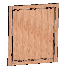

Re: changing door sizes
You can use a cabinet with all parts removed except the door. That will give you the resize ability.
Cab as panel.jpg (13.71 KiB) Viewed 10969 times
Cab as panel.hsf
(62.02 KiB) Downloaded 609 times

Rick when I try this the door disappears when I remove all of the parts.
Scott Marshburn
Posts: 867
Location: Jacksonville Nc
Post by Scott Marshburn »
Ok I see. I used a standard frameless cabinet without any doors removed all of the parts then went to door editor clicked in the center of the blank screen (where the opening should be)clicked on add right hinged door A message popped up that I had to select a opening first then a outline of the opening appierd.then I selected this opening and was able to add the door.
