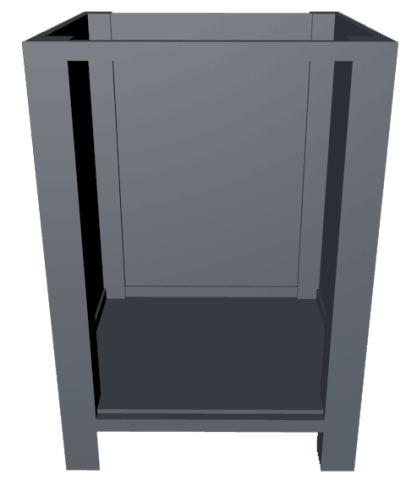

Hi
Sorry for not getting back sooner.
I have been working on this and have got it working as a resizeable cabinet.
What do you think of it (the different woods show the woods used to make it with this is a panted unit to the end user)?
If ant one want it at this stage it is only a seed cabinet all with butt Construction.
