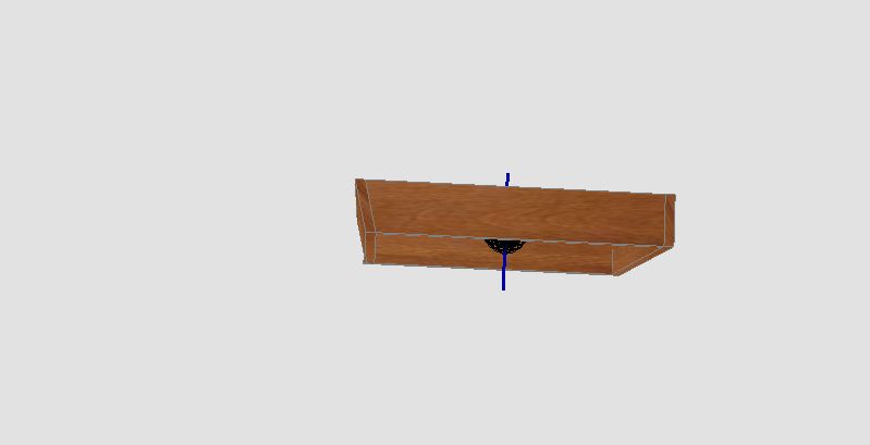

Ok I attached thew cabinet in a jpeg so you can see I hope what I am doing. What I am asking is,How do make the Profile cut and the Part Editor cuts exactly 15 degrees or make any certain angle for that matter. 45 degrees you can make a square then bisect the corners. But say you want. 43 degrees, or 25 degrees in Part Editor Is there a way to do this?
cabinet with almost 15 degree angles.

by Mark McCallum
Hi Greg
In the contour section of the part editor, right click angle snap a couple of times to select and deselect. There you can put in the angle you would like.
I hope this makes sense.
:D
Re: Making angle cuts
Posted: Tue, Jul 31 2012, 8:45AM
by Greg Haw
Thanks Mark exactly what I was looking for.
