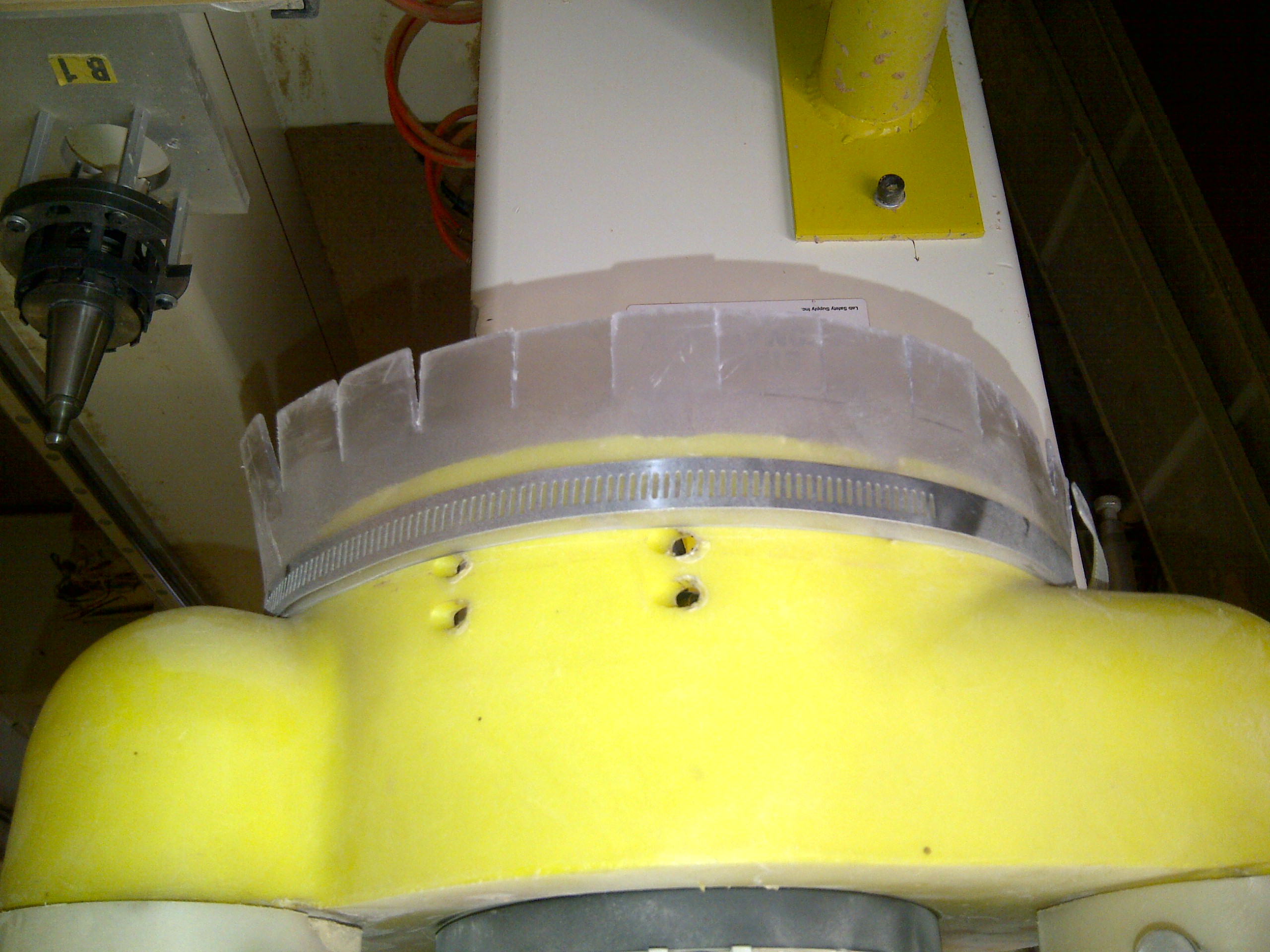

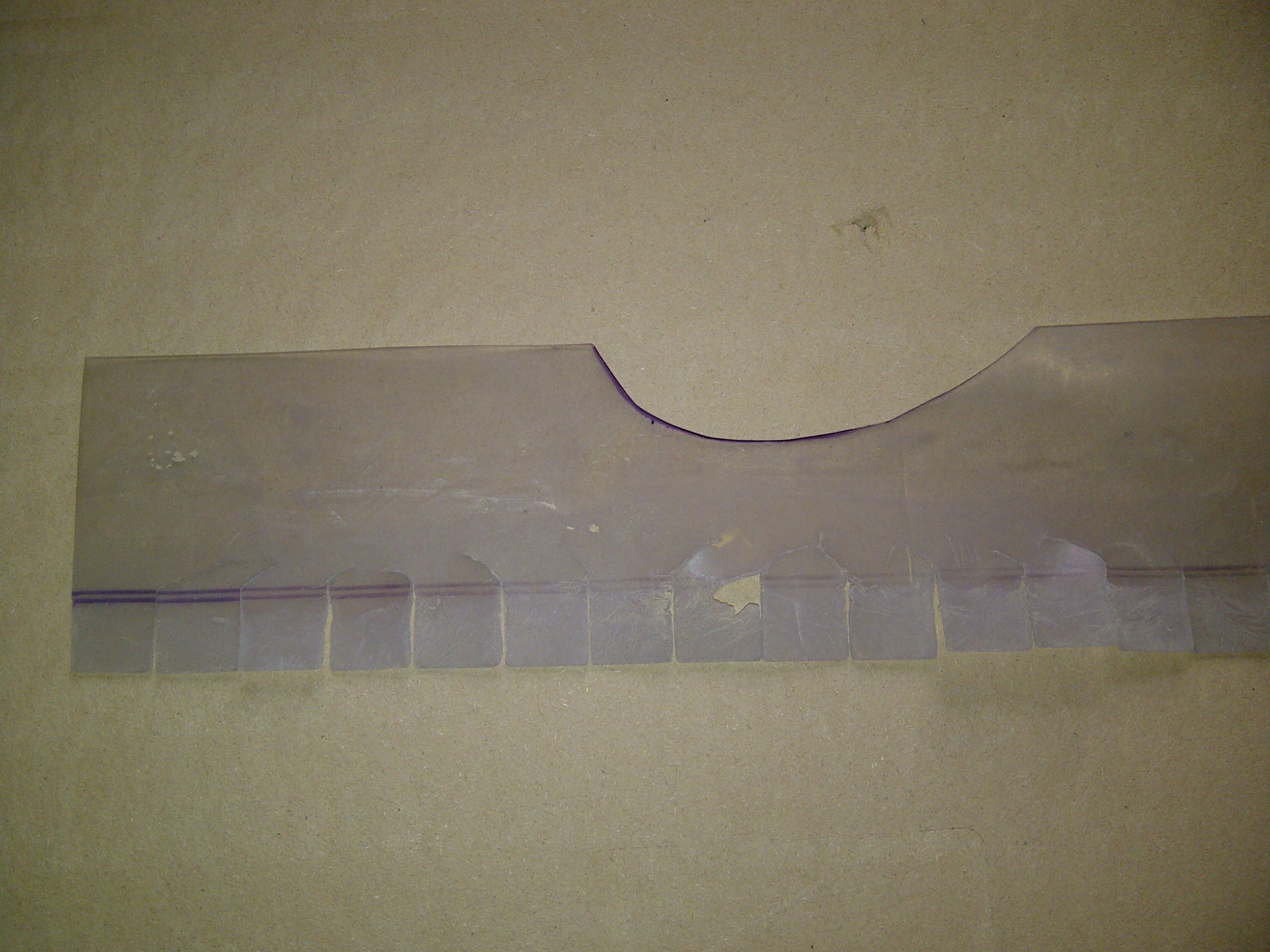

We have a CS40 and there are two 4" pipes coming down so I am not sure if this will help.
We make a plastic type brush using the heavy plastic from walkin freezers.
I make long so it touches the material that we are cutting and the dust pick up is really good.
I can't tell from the pics of the 43 and did not pay attention at the show but if you notice on our hood there are holes on a angle just above the skirt, this creates a tornado effect to help lift the dust.
When we cut MDF Doors there are times when the dust really packs in there so we are looking at running a air line inside the hood and when the operator feels it is necessary he can manually send a couple bursts of air, this avoids your compressor running constantly.
Hope this helps.
Steve

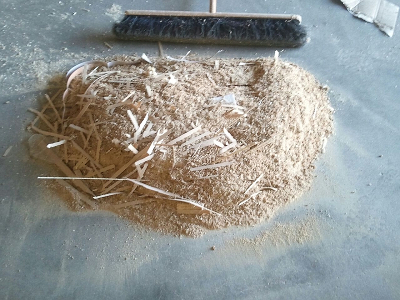

This is the dust that hit the floor from 17 sheets. That is a 24" broom. This seems excessive. This is MDF but I get the same pile from plywood.
We are going to try running a six inch flex line to the machine and reduce to 4" at the spindle.
