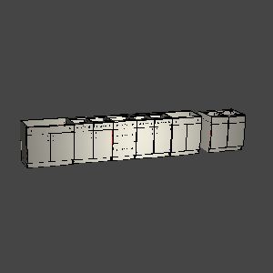

Not sure if I did this right but here is the files.
New Building.esa
(6.06 MiB) Downloaded 893 times
New Building.jpg (7.41 KiB) Viewed 9584 times
Scott G Vaal
Re: Drawer adjuster constraints question?
Post by Scott G Vaal »
Terry,
I see what you are talking about now and will get it added to the list to be fixed. If you regenerate the cabinet, the holes will then display correctly (Construction settings, then select OK). As you said, it will still nest and CNC correctly but not graphically till a regen. Sorry for the inconvenience.
