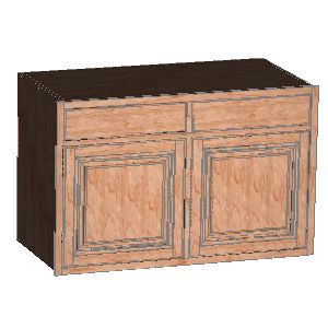

Is there anyway to show beaded face frames with inset doors??
Chris

Try these. Use the bead tool for edge profile on stiles and rails. The cabinet doors and drawers are .75" inset.
BASE_2 DW_48.jpg (14.83 KiB) Viewed 8612 times

I'm not quite understanding how to do this.
how is the bead tool used on FF rails/stiles?
