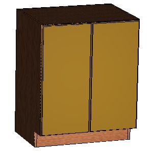

Hey Steven, I was able to create a cabinet with doors made from stretchers. You can profile the doors,and re-size the cab. Unfortunately, it's not a door. So it won't retain the properties that a door would, (hinge patterns, etc). But for demonstration and sizing, it will work. Hope this helps.

Thanks Rick, there are a number of ways to make doors but i was hoping to keep it as a door.

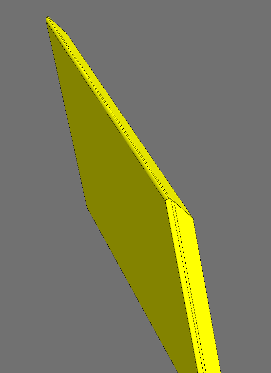

this will be my door and draw if i get it to work.

Problem is it’s a different profile on the top compared to the other 3 sides.
