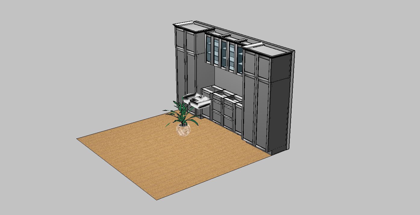

Heres a pic. Just picked a sink and plant at random. How to move these objects closer/further from wall??

Do you have a left or right wall. If not create a left or right wall and associate the object to that wall. Then go to the elevation view for that wall and type in your coordinates. I have no problem moving these objects in plan view left and right forward and back by selecting it and holding shift and using the up,down,left and right arrow keys. The only way that I know of to move the object up and down is by associating it to a wall and then go to the elevation view.

Select the object. Hold the Control key and move it left, right, up or down with the right mouse button.

Also try setting your "Place Mode" to Free style that sometimes helps as well.
