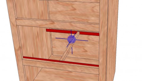

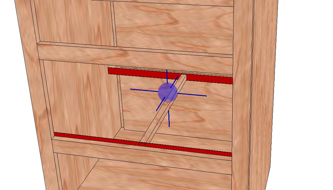

Re: Drawer with Stretcher?
Nat
You could create a stretcher using dummy stretchers associated to the rails This will allow them to adjust with the cabinet but they will not be part of your drawer but you could name them for example Drawer stretcher. We usually just make the bottoms on large drawers out of 3/4 material.
