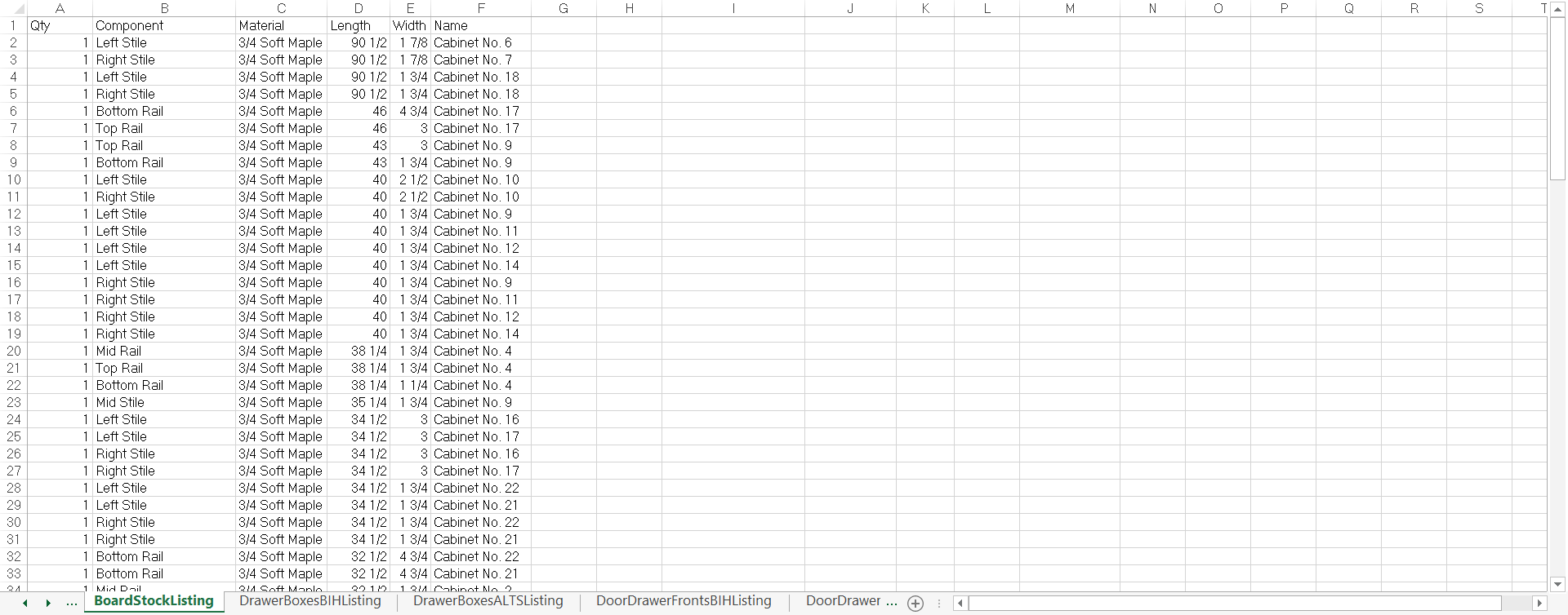

Here are some screen shots of eCabinets BoardStockListing before and after Modifying in Excel

A lot of my jobs come in on an excel spreadsheet. I've built macros to format that info and then I import into ecabs as a batch file. It even selects the right directory depending on door overlay, etc.
After ecabs has worked it's magic and I've made any necessary modifications I save, create the twd and export the cutlist. After a bunch more macros, I've got labels and code to cut rails and stiles , door and face frames, on my CNC chop saw. I also have door panel sizes which I can import pack in for flat panel doors for thee machine to cut. Seems that there are other things it does, but that's all I can think of for now.
This whole excel - ecabs combination has greatly decreased time and virtually eliminated errors.

- Scott Marshburn
- Posts: 865
- Location: Jacksonville Nc
Re: New Forum Category
Ok. Some of you may be thinking so how would this code help me.
I came up with this code to use in my Finish Calculation workbook I just modified it so that it can be put into a module in the personal workbook
Before I came up with this macro I had to either look through the paper work and type each cabinet size line by line.
Or toggle back and forth from excel to the eCabinet cultist again typing each cabinet size line by line.
This proses would take from 10 to 30 minuets for me to do.
As you can see in the video. What would have taken me 15 minuets took just a few seconds
I guess the point that I am trying to make is that If this category was available then users could ask for help on how to accomplish task like this.
That is of Corse if there are any eCabinet members out there that are willing to lend there help
http://screencast.com/t/0n0QjpgNLuc
