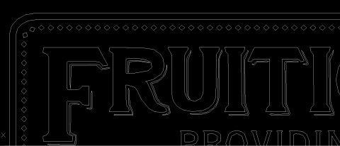

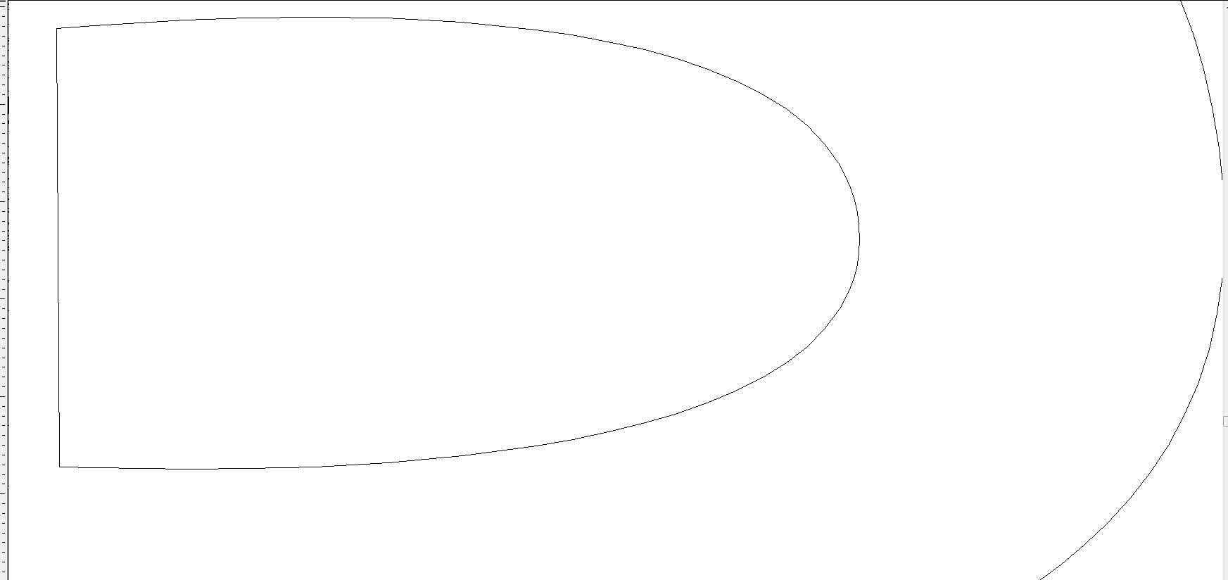

Thanks for looking into this. The scaling is strange. I've imported the AI files into Ecabs fine after exploding it a number of times. Having segmented arcs will not work for me. Especially in dealing with typography.
I've attached two images of the client supplied artwork. Export out to another CAM program and its scale and vectors import fine. A close up of the R confirms the curves are intact.

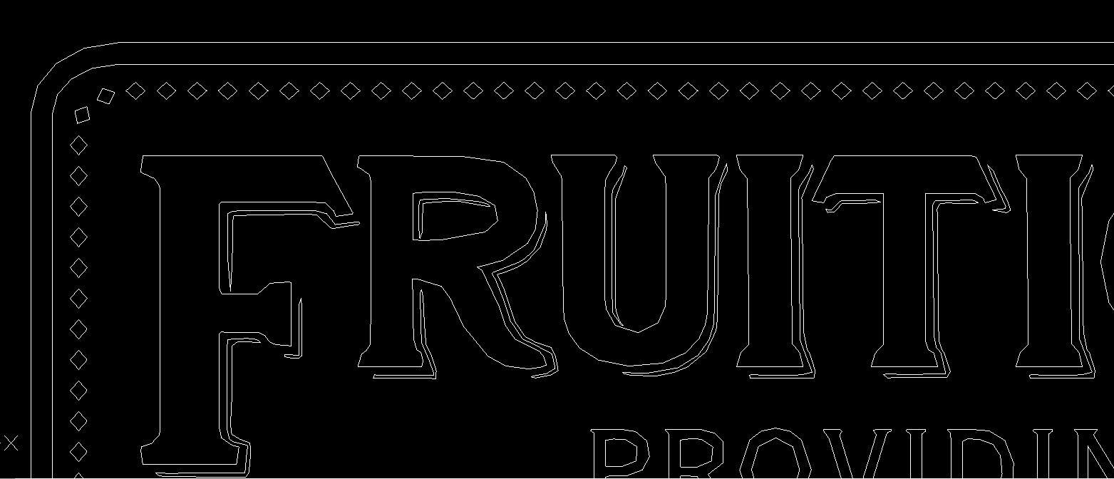

Interestingly, this was the result of the ai vectors taken into the recommended Draftsight.
were going thru the steps as outlined in Larry's PDF and I will post the results.

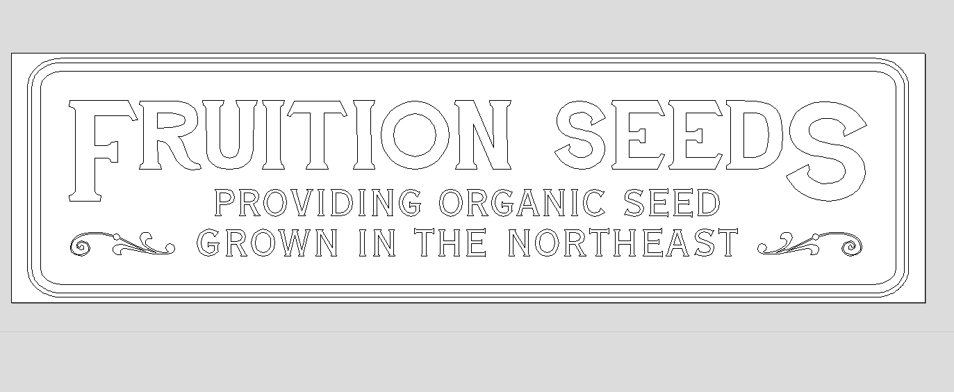

Success!
Reduced the amount of anchor points and it worked!
Brought the DXF into my CAD program and repositioned it to the 0,0. Het explode and saved it off again. Went thru the necessary steps in ecabs and VIOLA!... She took it. Took some time but not nearly as long as the first go around. Added 205 anchor points to graphics in AI. and this was the result. Maybe less would have worked all right, also.
I guess it will take some experimenting on our part to find out how many anchor points will be enough. I'm pleased with the results of this though. Larger arcs appear to be smooth. We're very encouraged by this. I'm ignorant to the why's and wherefores of anchor points but it appears like its a good workaround. Have to look into those anchors more.

Postby Dennis Englert » Wed, Feb 05 2014, 2:44PM
I think the anchor points can give you a good base to redraw some of the geometry. The larger arcs and even the line on the bottom are created with a series of small lines. You can replace the line(s) on the bottom with a single line and the two arcs (line segments) at the base with two arcs. You will get smoother results when you machine those.
