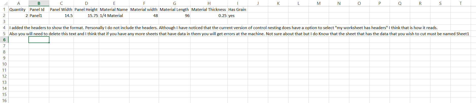

See attached screen shot of the format that we use
From what I under stand OppenOffice will not save as current excel versions like .xlxs. But if you are sending the file to the machine it has to be a .xls file anyhow
Also I have found from my experience that there cannot be any formulas in the file either. I have tried and I get a numeric overload error when doing so
