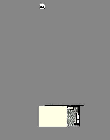

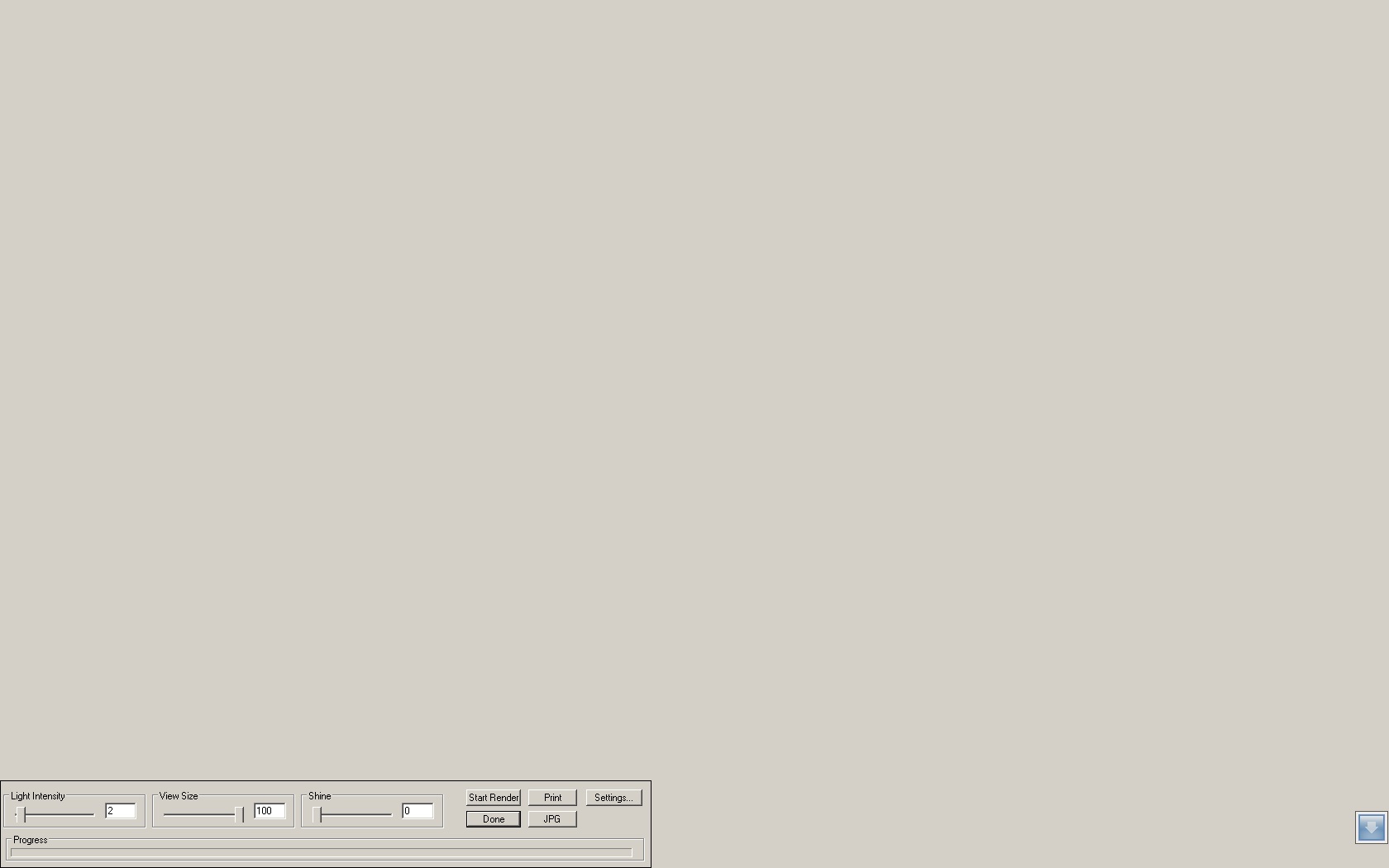

This is what I keep getting when I try to render something. Obviously needs a fix. A couple of times it worked today but when I tried adjusting my lighting. It started striping everything piece by piece out of the room.
There is also a problem (might be me) with reflections. I'm getting reflections of a cabinet on a wall where it would be near impossible to have a reflection. No cabinet on the opposing walls. :wall:
George

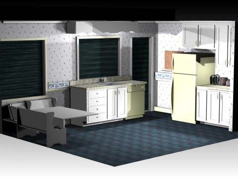

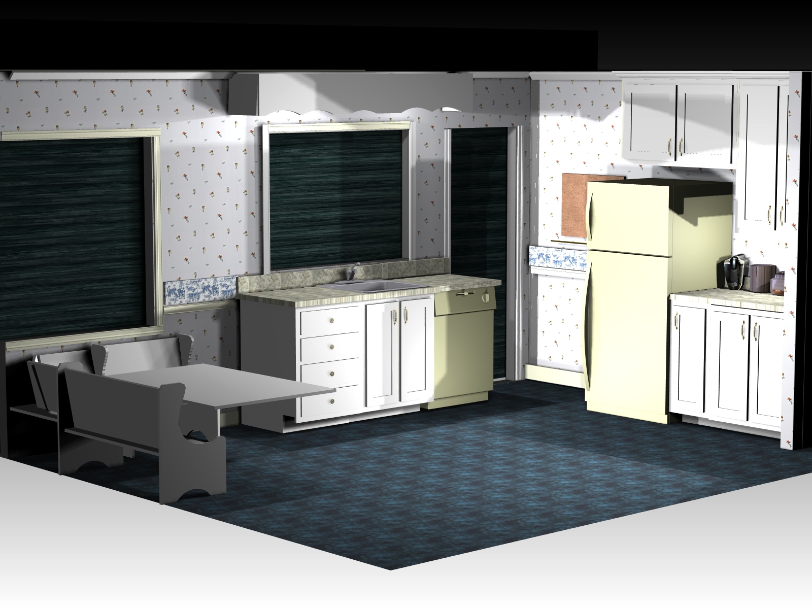

Well today it's still at it. Here is another shot. Notice half of the cabinets are gone (all of the base cabinets) Some of the display objects are gone and parts of other display objects are missing, bi-fold doors.
I'm trying to experiment with lighting and it's really frustrating when the under the counter lights have nothing to shine on.

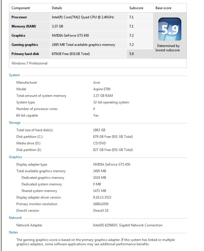

Can you please let us know your PC specs including what graphics card you are using. Are you on a laptop or desktop? If you have told us this before, please forgive me.

I tried to attach that file but I think it must be too big. Even zipped it's 15MB I did attach my specs. I have a 1 TB hard drive with a ton of space available.

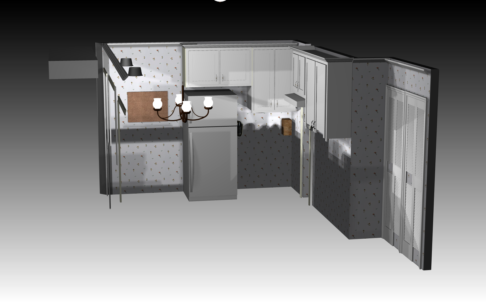

Today it's giving me a new headache. The file "out in space" is one. I tried changing the color of the appliances. When I tried to add a dishwasher it sent my stove way out in left field. It did it last night too only with the fridge. I finally got it, but I had to shut the program down 3 times.

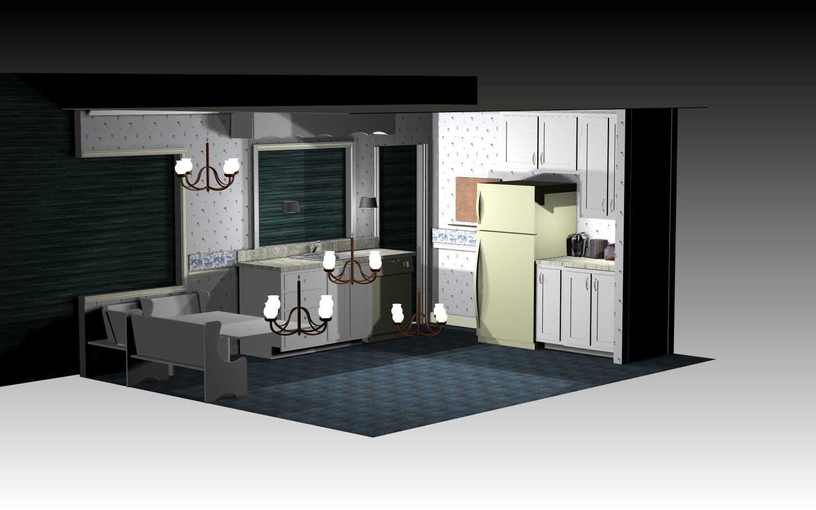

Presentation mode is still giving me a headache too. Take a look at the pic of lighting. All of those chandeliers are set to 0, the counter lights are set to 10. I also dialed back the lighting on the bottom to 0. I have walls blocking any incoming lights similar to the one you see behind the windows. Where is all that light coming from??? Set to 0 the room should be dark except for the counter lights shouldn't it? :wall: Also no matter where I place a light I can't get any light on that dishwasher. I also have the "lighting effects" boxed unchecked. Shadows should be minimal at best.

Thanks, I got your job and tinkered around with it a little while. I cannot get the blank screen to happen here. I did notice that some of the cabinets that you said did not show at one point were associated to the wall that was hidden in your attached picture, so I believe that is why those seemed to disappear. I was able to set some intensity to the light closest to the dishwasher and it gained light. everything seems to work as it should in the Pres view for me. The Apply Lighting Effects check box only pertains to the Render view and does not change any behavior in the Pres View. The To be able to help with the blank screen that happens to you, we would probably need to connect to your PC and check it out first hand. If you would like to pursue that, just get with me and we can set up a time.
