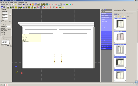

I don't know how I ended up with display panels on the sides of this cabinet, but I can't get rid of them. I've taken it into the cabinet editor, tried delete, tried a texture match. I could shuffle it by, but the different color sticks out like a sore thumb in the presentation mode. Any ideas?

Post the job and some steps and we will look at it. Zip the job before you post it or if you have trouble posting it, send it to cabinets@thermwood.com .

Are there applied ends? In the cabinet editor, right click and choose add/remove applied ends. Check both and remove applied ends and you should be good to go.

Same PITA file I sent you before. It's the cabinet over the refrigerator.
Rick
I did that too then I didn't have any sides on it at all.
I finally fixed the problem, I deleted the whole cabinet and started over. Now it's right
