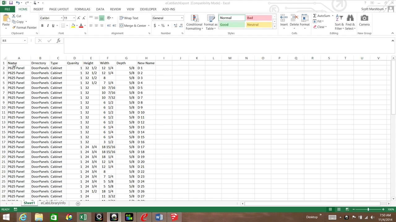

We use this feature often to export panels for our doors (5/8 Mdf as well as ¼ sheet stock). We have a library set up just for this purpose named for example Door panels. We took a cabinet with everything removed except for the back. And set up the materials for these backs to use for example 5/8 Mdf and ¼ Mdf. Then named the cabinets in the library for example P625 Panel and P25 Panel. After the panels have been Isolated you can copy the sizes of the panels to the excel file that you have set up for the export. And name them the same name that is in the library I.e. if you are using 5/8 sheet stock then the name in this example would be P625 Panel. You can rename the Cabinet name as Rick said See the Pix below. Note the New name column.
Ps. if you need to change the material type to something else like ¼ Cherry then you can click on change materials and select you ¼ cherry.
