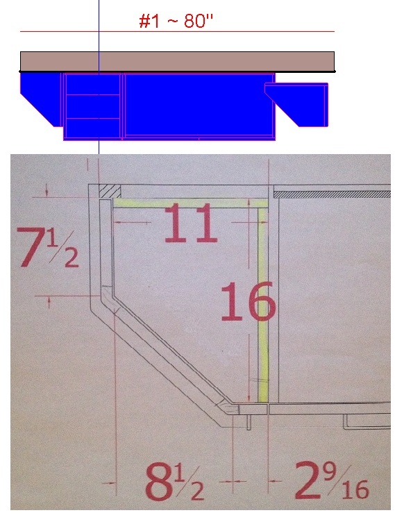

Not sure how to word my issues, But basically I started with a corner cabinet removed the left and right sides. I am using the left back of the cabinet as the back and then using the right back as my right side. But no matter what I seem to do I cannot duplicate the cabinet as a mirror image. I cannot seem to change the way the back overlap each other. and the cabinet on the far right I cannot get to sit on the wall correctly. The doors and toe kick is a seperate issue. Am I going about this all wrong? Im attaching the .esj file maybe someone can decipher what my problem is. Any help would be great.

I was able to place the cabinet in question by using the rotate tool. I then made sure that the cabinet was associated to the wall. I Disassociated the other cabinets from the wall then in elevation mode I set the cabinet to be 0 distance from the right end of the wall. I went back into the overhead view and clicked to the cabinet to the left if the corner cabinet and clicked on the corner cabinet this gave me the distance that I set in move increments for objects for example 3 15/16 then I moved it over by holding down the shift key and taping on the left arrow key.
You might have better luck placing this cabinet if you made a right version of it. For example make the left back the long side and the right back the short side. As far as the overlap issue I recommend checking the option to mightier 90 deg. Corner. This way you can either mightier the backs or cut the one you choose for the overlap.

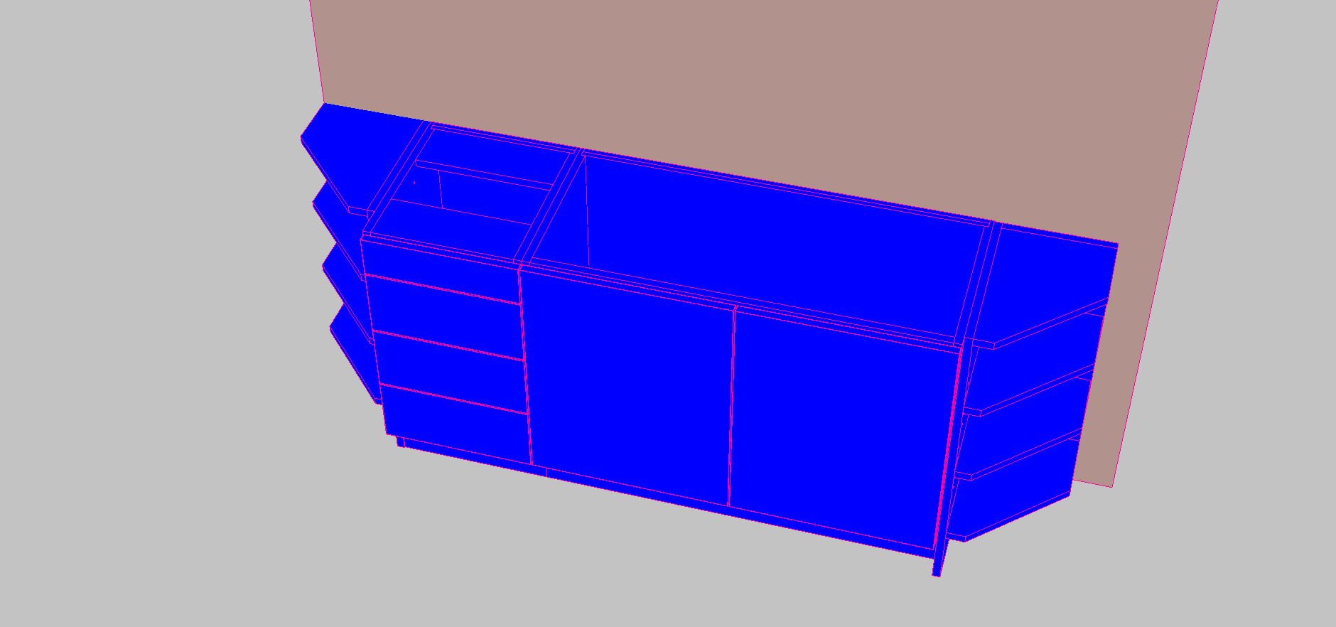

Thanks for the help! I did end up getting it by using a standard frameless cabinet and removing the right end on one of them. On the other one I removed the left end. Drew the shapes in autocad and saved the .dxf's. Then used the part editor to cut the shapes.
