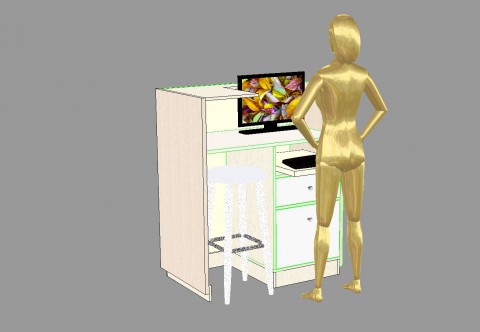

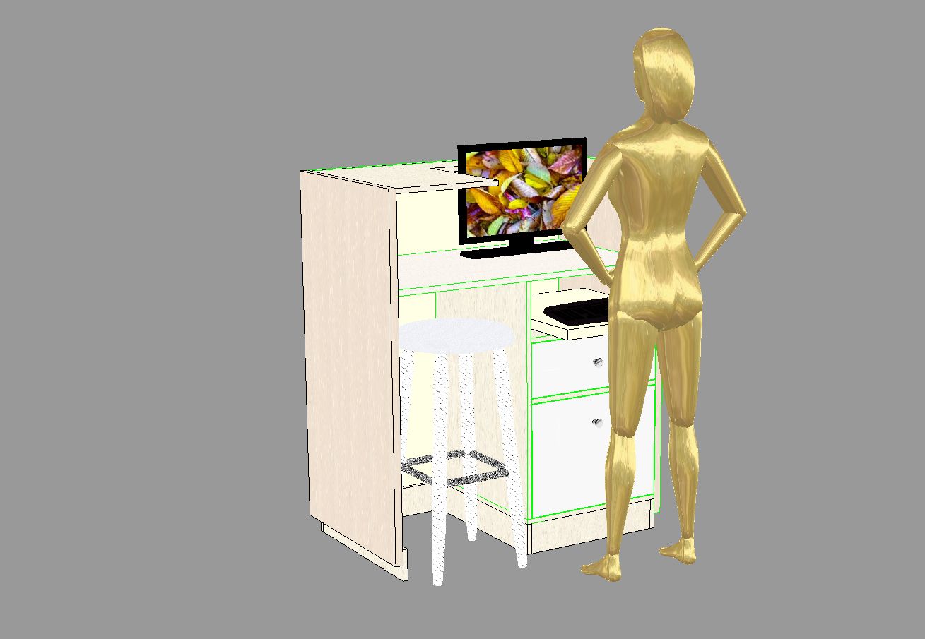

In the picture I have highlighted a piece (green cross hatching) one click to deselect and it removes that part of the green unit highlight). But the whole unit is still selected.
