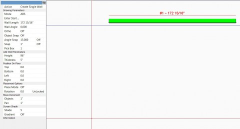

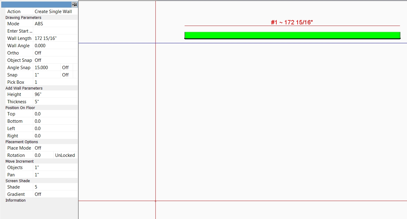

Hi Jeff -- Yes you should be able to click and make a wall and yes the dims. should move as you move your mouse. Here is a screen shot for you to see if all settings are the same as yours. Did you try a different mouse yet? That sure could be it. Click on it (The pic) to zoom.

Wally, thank you sir for the screen shot! Something was set wrong I think it was the move increment settings, I had objects set to 3/16 for some reason. Now we are back to normal, if you lived here in my town I would buying you a beer!
