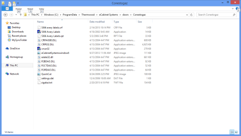

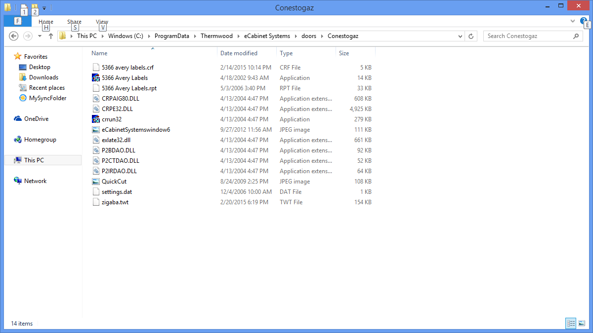

Is there a file called C:\ProgramData\Thermwood\eCabinet Systems\doors\Conestogaz\zigabax.twt? If so delete it. If you don't mind, can you post a screen shot of your C:\ProgramData\Thermwood\eCabinet Systems\doors\Conestogaz directory?

Rick Deskins wrote:Is there a file called C:\ProgramData\Thermwood\eCabinet Systems\doors\Conestogaz\zigabax.twt? If so delete it. If you don't mind, can you post a screen shot of your C:\ProgramData\Thermwood\eCabinet Systems\doors\Conestogaz directory?
There was so I deleted it. Here is a screen shot.
