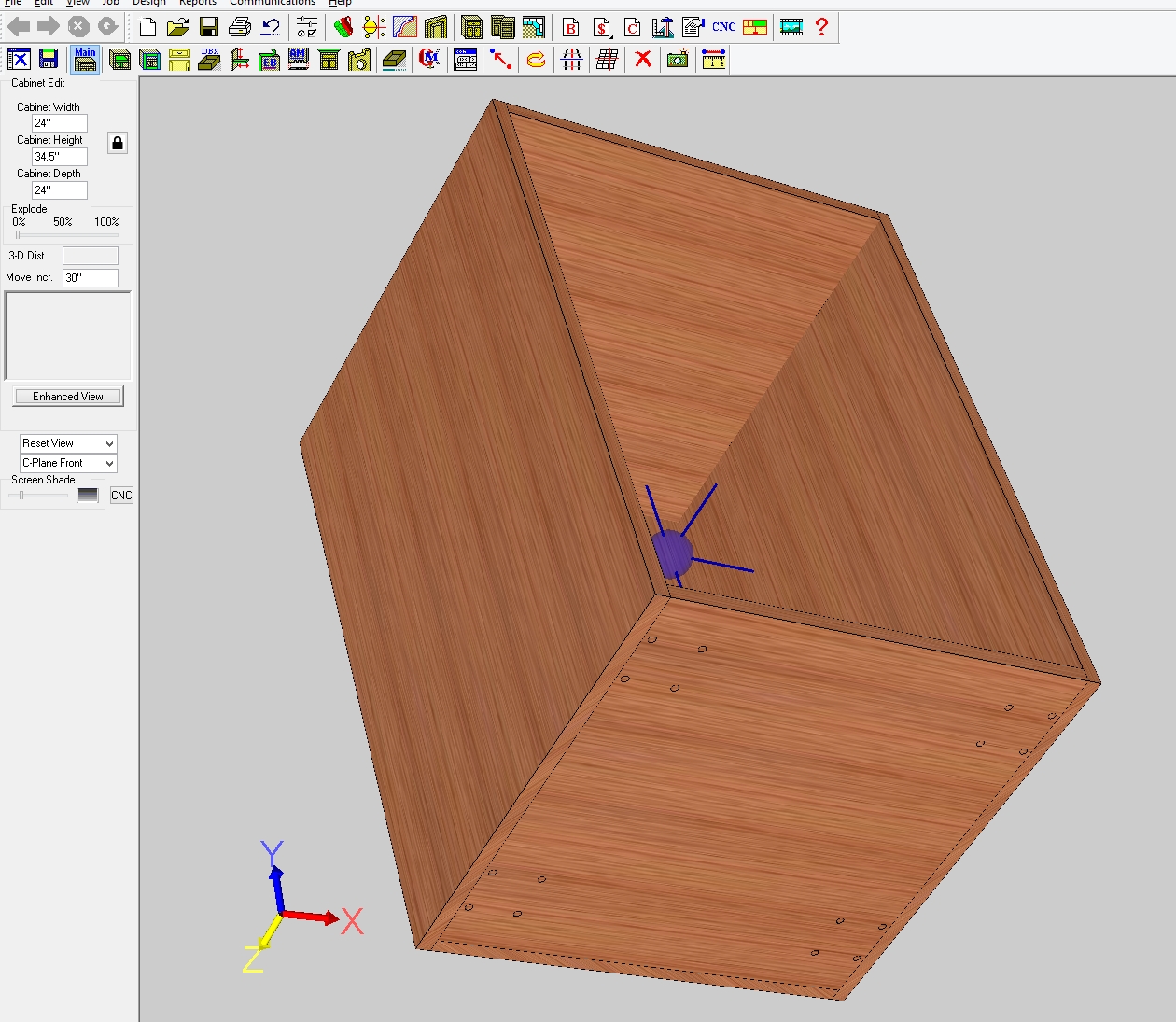

Ariane,
Here is an example of using the KD/RTA construction and a special hole pattern to achieve holes on the deck for levelers. I will attach the cabinet and the hole pattern I made and used (I had to rename the extension for the pattern file to .txt to attach it here -- just rename it to .ptn after downloading it). Hope this helps.
