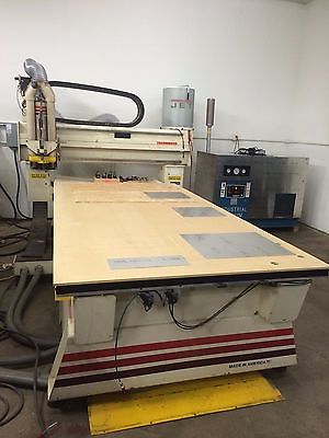

I am close to pulling the trigger on a 1994 Thermwood C53. 10hp spindle, 25hp Quincy pump for Vac hold down, Jet 1.5hp on board dust collection, power draw bar for quick tool change and 91000 super controller with OS2. Legacy components but still runs well. Old version of MasterCam. Current owner still unfamiliar with the system mostly having only bought it about a year ago and it doesn't really fit into his operation (he is switching to a laser cutter).

Bryan, it looks like things have been upgraded at some point as the 91000 controller didn't come out until early 2000's. It would be interesting to see if it has a belt driven spindle or direct drive. I don't think the belt drive units had auto tool change capabilities. At first glance I believe it will do anything you want it to though.
Find out what type motor it has, version of windows, version of controller software and we can make a better assessment.

Thank you! I am checking on the full specs and have yet to actually demo the unit (hoping to this week). Owner says it runs on OS2 (archaic, I know). Trying to confirm the actuall controller. Tried posting a pciture...No ATC - but there is a power draw bar with BT30 collets for quick change (no wrench)

i would not use DXF file unless absolutely necessary. DWG is a better file . less segments machine runs smoother. just my Humble opinion. With the money you save you can get a new controller GEN 2 and be up and running. if it is a belt driven motor call Thermwood to see what it would take to upgrade it to a HSD with ATC capabilities and get a table mount tool changer. I have a 2002 C40 and 2002 C42 both run win 2000 and 91000 THM 5.05
