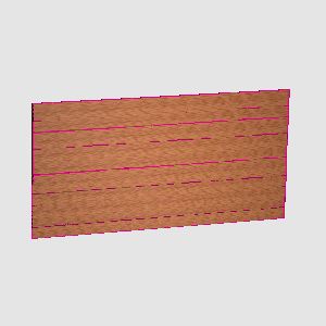

48 X 96 Paneling V Groove.JPG (9.97 KiB) Viewed 4381 times
I have to make a few pieces of paneling with a V Groove.
I have Drawn the 90° Bit and created the .tol file
when i nest in ecabs I cannot see any of the tool paths for the V bit.
I output to the machine then open in profile modeler.
I can see all the tool paths but get "Region" errors.
I have used the profile modeler to do miters on cabinet sides using a 1/2 in strait bit.
I have taken out my 1/2 strait bit and replaced it with a V bit and cannot get a simple
center line cut .037 deep.
Driving me nuts!!!

Got it!
Had to Choose Custom Tool in profile modeler for each region.
