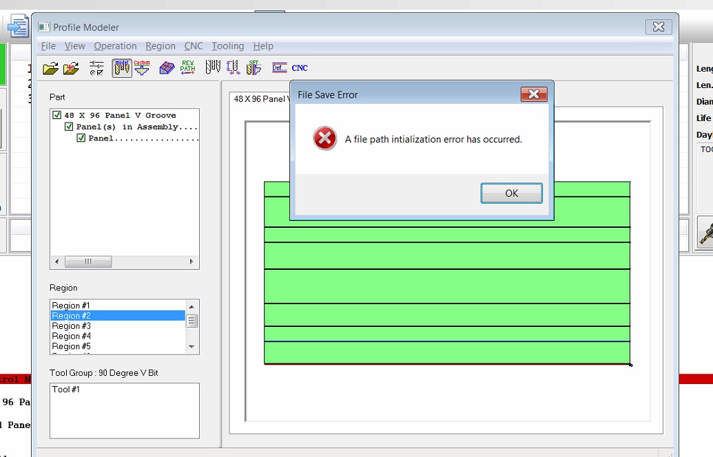

Post by Troy Hollinshead »
In the Profile Modeler I changed the Regions then hit save and I get the Error.

ive been getting the same error ill post a new thread and hope to get it resolved

You might be missing a file or have a bad file that is needed for this process. Unzip the attachment and place zigaba.twt1 in the following directory.
c:\Profile Modeler\TWD

Yeah that file was missing out of that directory and now it works. Curious though as I was missing this file on both my thermwood desktop and the cnc controller. could you check profile modeler and make sure its packed in by default.
