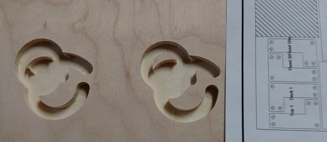

Just cut a cabinet using the Shopbot link and the pocket holes are out of shape
Tim
they should be round holes created in part editorPocket hole in shopbot link

Can you send a shopbot link export to cabinets@thermwood.com?

Seems to be a problem with pocket holes with the "Pocket Setting" in the link set to "Spiral" unless you set it with the "Outside-In Cut" checked, then it works just right
Rick
