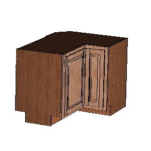

BLS36 peninsula.jpg (11.75 KiB) Viewed 26512 times
BLS36 peninsula.hsf
(480.02 KiB) Downloaded 1606 times
can use this? you will need to add another cabinet to use just the face frame on the back and a display board for the toe kick then save it as an assembly

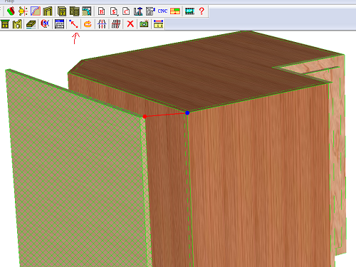

yes thank you Tim. I have added a display panel, but I can't snap or drag it into position
tim lucas
Posts: 322
Location: bell, florida
Re: peninsula finished backs
Post by tim lucas »
Mike Lewandowski wrote:yes thank you Tim. I have added a display panel, but I can't snap or drag it into position
Shift left click on the cabinet, the whole cabinet will highlight (not cross hatched, but highlight)
left click without shift on the panel it will be cross hatched - now when you mouse over the cabinet in spots it will light up Blue
left click on a corner of the Cabinet Blue - blue dot should stay
mouse over the panel corner that you want to align to the cabinet corner - it will light up Red
then click the alignment tool and you can align it
Remember it aligns RED to Blue - do not forget to associate the panel to the cabinet - I had to rotate the panel 45 degrees before I aligned it

Posts: 26
Joined: Thu, Feb 08 2007, 8:34PM
Post by Mike Lew »
Thank you Tim for the secret combination!
also important was the distinction between highlighted and cross hatched. While I appreciate how difficult it must be to improve this program, it seems like a lot of tricky steps just to add a finished back to an island or peninsula. The journey continues...
