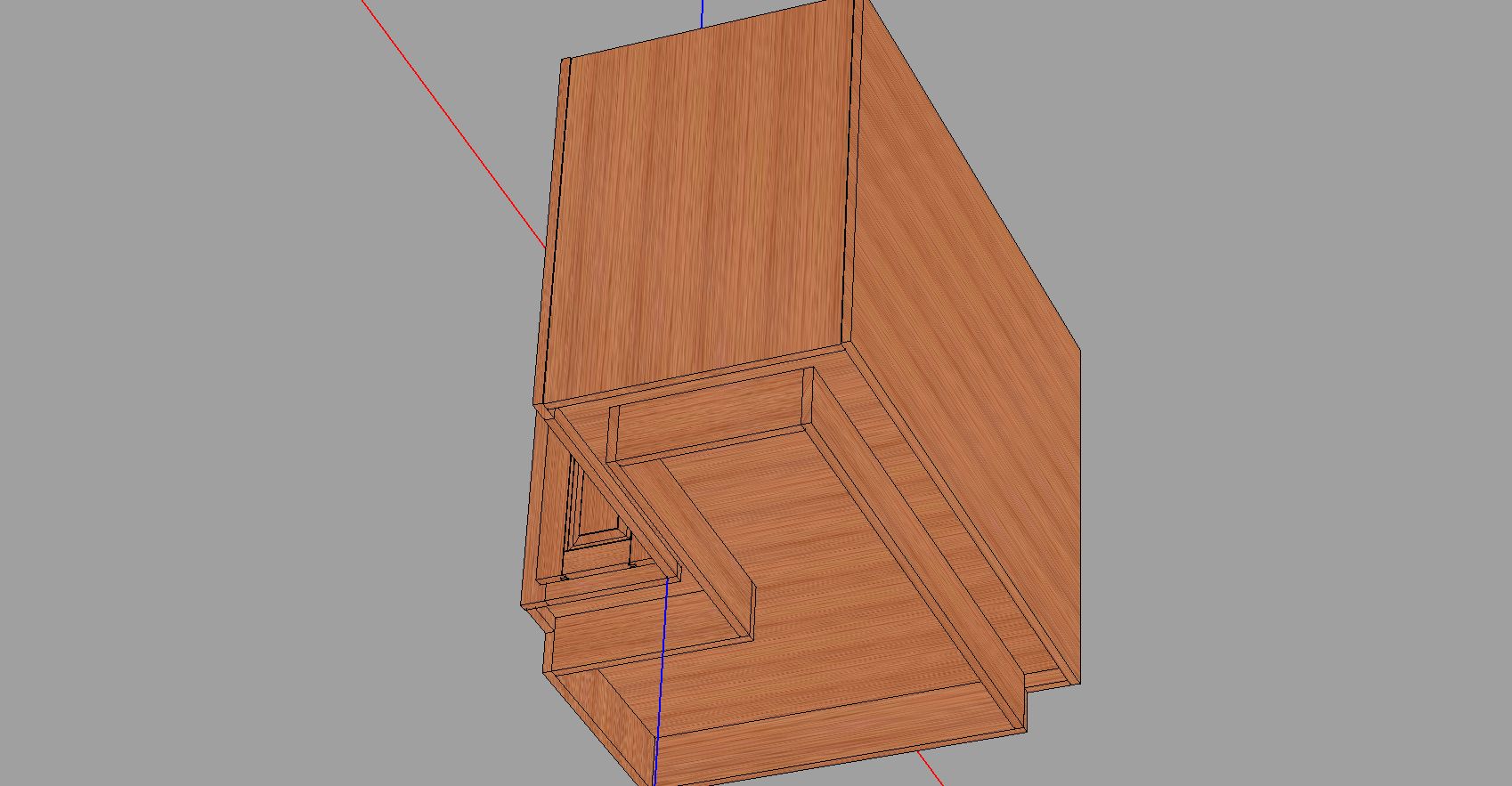

The picture is of an island that I put together in the CE, I believe it is simpler now to place it in a room.

The cabinet in the photo was made using the original back with the grain rotated 90 deg.

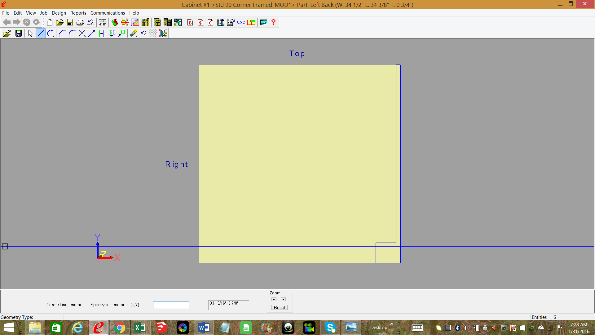

Then I took the left back into the part editor. Note that when the part is loaded in the part editor it says that the right of the part is actually on the left of the screen.
In the contour area I created edges and used the offset tool to create the geometry for a pocket that cut ¾” off of the right side (the side to the right of the screen) as well as the toe kick cut out. See The "Left back" Screen shot.
I then exited the contour mode and cut the pocket. Then returned to main keeping the changes.

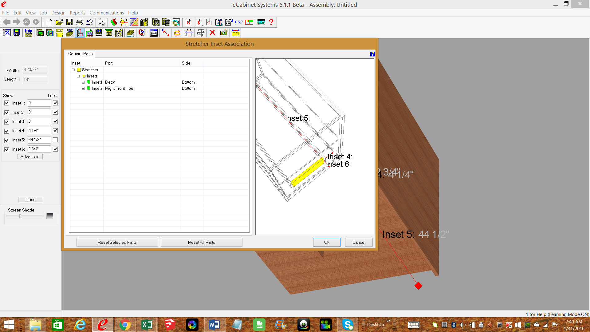

For the finished end toe. I created a stretcher/Sleeper by selecting the right back (the finished back in this case) and the right front toe. Then applied the insets and advanced settings as per the screen shot "finished end toe settings".
For the Back toe I created another stretcher/sleeper by selecting the left back and the left front toe. Then applied the insets and advanced settings as per the screen shot "back toe settings".
