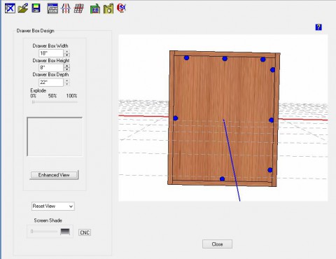

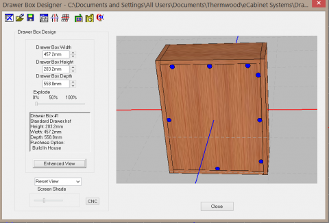

Interesting, I get the same result on 2 different computers. I've attached an image to help clarify. Notice how the left edge and back edge are the parts that are affected by changing the max edge length settings for the left edge and right edge.

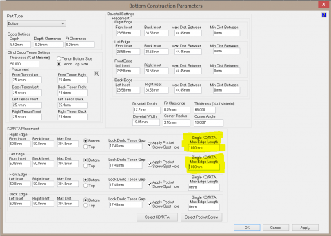

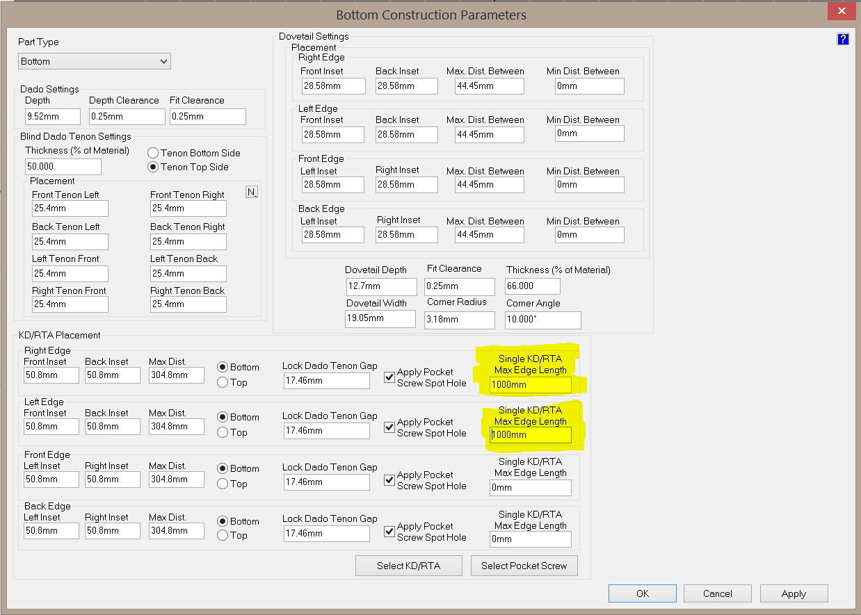

Hm, the plot thickens. One of the two computers I tested on is set to imperial, so apparently that's not it either. I notice you have two RTA connectors on the left and right edges. With the huge Max Edge Length, you should only be getting one per edge. Are you sure you're not changing the Max Distance setting instead of the Single KD/RTA Max Edge Length? I've attached a picture to show which settings I'm changing to achieve the (un)desired result...

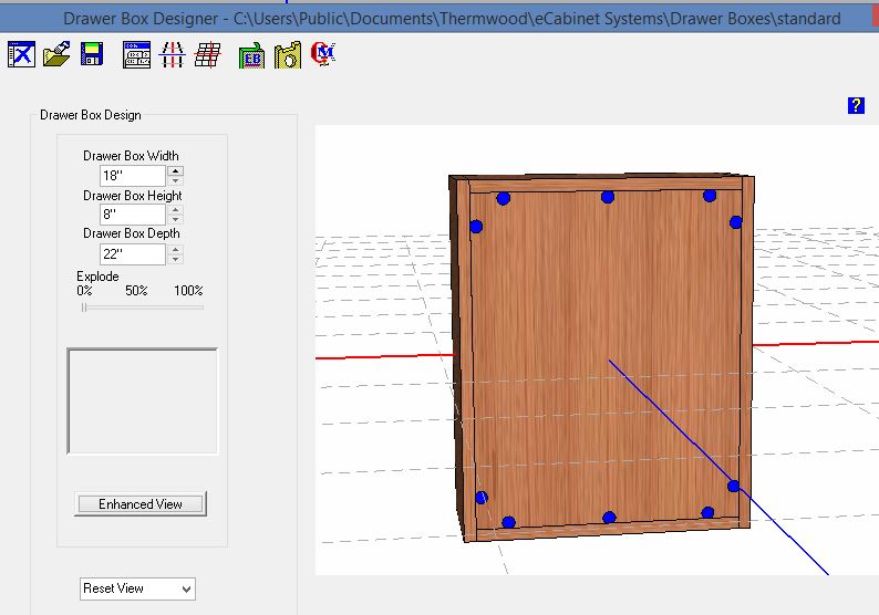

I misread your post and chose max distance instead of max edge. My apologies. Here is my new pic.
