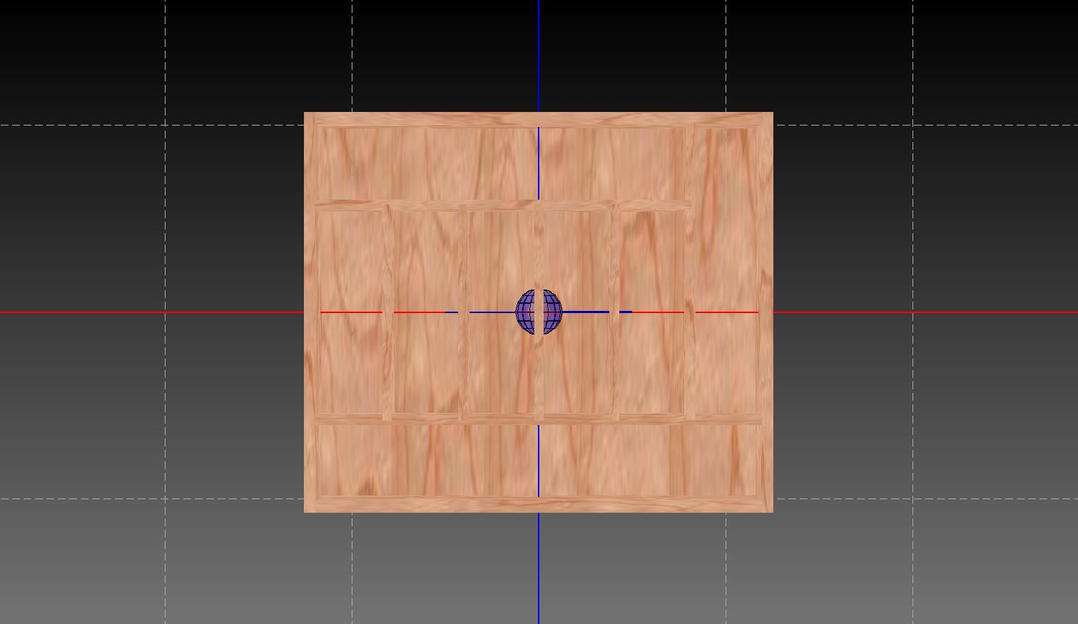

Has anyone come up with a systemic way of accomplishing this?
A great example would be a lateral file cabinet that has been divided to facilitate files running front to back instead of side to side. The only work around I can see is to make the drawer as a separate cabinet and associate. This could be really cumbersome if the cabinet sizes are more than just a few. TIA!

Hi. Stuart. Here is a video where I demonstrate how I drew an under sink drawer using stretchers. You should be able to use the same concept to achieve the type of drawer you are after. https://www.youtube.com/watch?v=DectdhQ ... 2&index=10
These workarounds are great, and certainly get the job done. Scott, I love your videos! I need to binge watch them all and really spread my wings.
I hope the software team is working on being able to do this in the drawerbox editor just the same. It's kind of a critical component for many types of cabinets.

Thanks Steuart. for watching my videos. I agree with you on having the ability to place partitions or at least stretchers in our drawer boxes. This comes up frequently
for us on custom jobs
