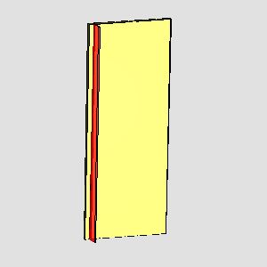

Here is the part I created... it adjusts fine in ecabs, but ignores the opening lock when imported from excel.

oops, here is the .hsf
FLOOR1L0W.hsf
(172.02 KiB) Downloaded 1142 times
