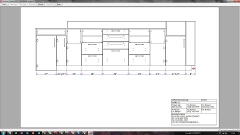

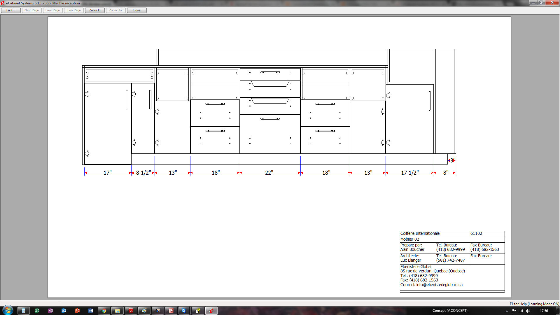

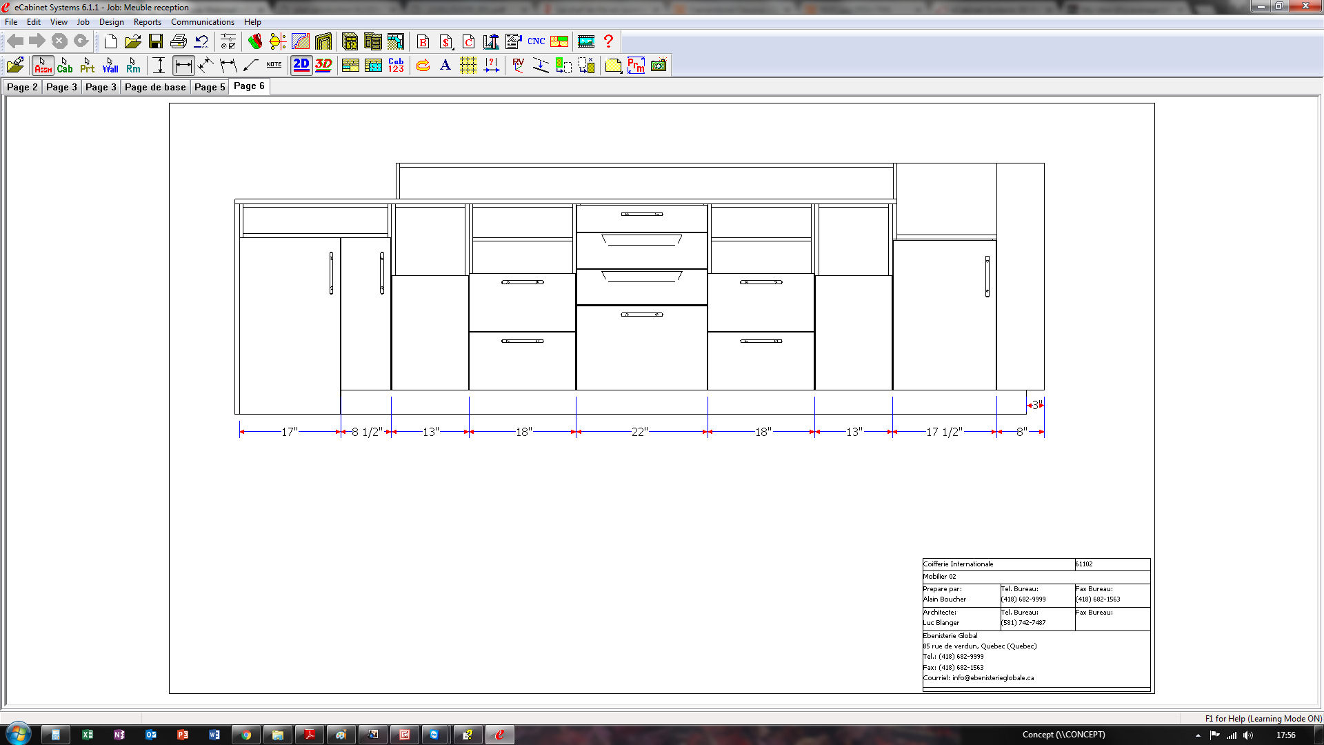

When a set the ''Line Enhance'' so there are some lines that I can hide it appears to be perfect.
But when I print, all the lines appears again. Is there a way to print and get exactly the same thing?

I have this same issue. Try to change your printers resolution. I have found higher res and those construction holes go away. At this point, I just print to a 1200dpi PDF and then out to my printer. Some cad programs will even bring that PDF in.
