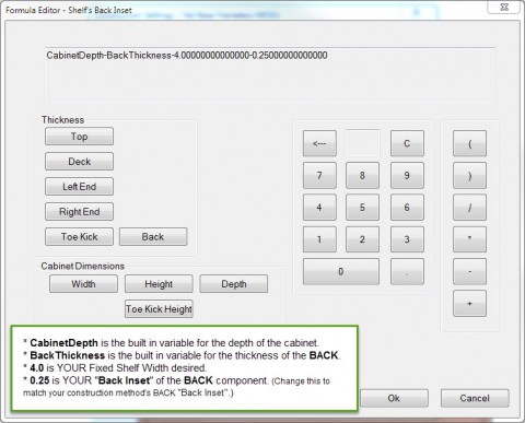

Try the following in the "Shelf/Partion Editor":
CabinetDepth-BackThickness-4.00000000000000-0.25000000000000
Where:
Where:
- CabinetDepth is the built in variable for the depth of the cabinet.
 - BackThickness is the built in variable for the thickness of the BACK.
 - 4.0 is YOUR Fixed Shelf Width desired.
 - 0.25 is YOUR "Back Inset" of the BACK component. (Change this to match your construction method's BACK "Back Inset".)

I just want to point out that I was assuming a "drawer stretcher" sort of application. The same sort of thing could be done when applied to the "Front Offset".
