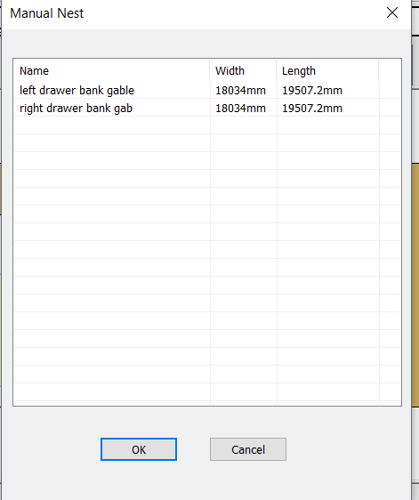

in the manual nest clipboard the metric values aren't correct

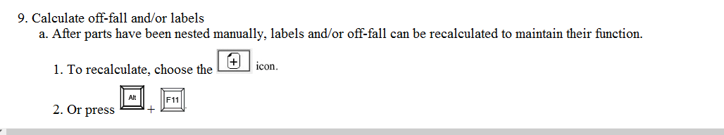

in the instructions inside the help manual the number 9 has the wrong picture...

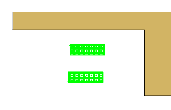

and if you select two parts and move them constrained and wiggle your mouse up and down they will slowly drift apart

The metric issue on the clipboard looks to be a bug so we will look into correcting it.
Icon in the help manual should get updated for the next release.
We will look more into the parts drifting apart.
