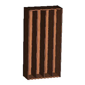

Yes ecabinets can be used for closet cabinets quickly and easily. Think of your cabinet in this way, I took a standard wall cabinet added partitions and now you have inside sides shared. Just add fixed shelves and adjustable shelves where you want. You can resize it and it will all adjust. Here is my sample. wasn't sure if you use backs or not so I left it in but if you need to remove it just right click, select construction settings, select back and uncheck it. You should try to make just one cabinet exactly the way you want to build it, get it right then you use it as the main cabinet to create more cabinets.
The online training is well worth the money and will give you ideas on creating better cabinets / closets. Hope this helps.

To use this cabinet just download the picture and the file and put them in your cabinet library.
Tim
