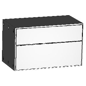

Thank you for taking a look at this. Attached is the cabinet file
Miter stand cabinet_ PH.jpg (9.4 KiB) Viewed 16044 times
Miter stand cabinet_ PH.hsf
(1004.02 KiB) Downloaded 1467 times
