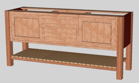

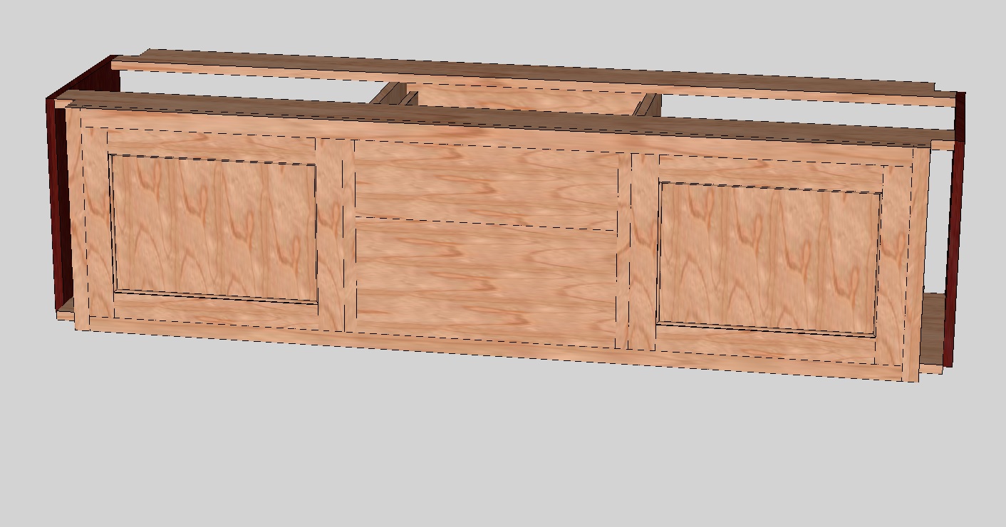

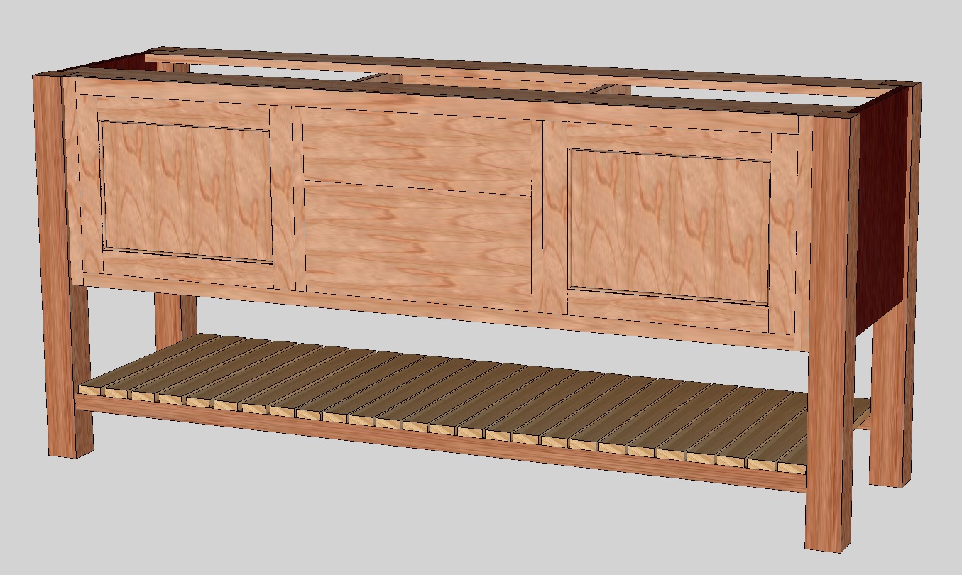

I just spent over an hour carefully adding and positioning display boards to a cabinet. I saved the cabinet then saved the changes to the batch that the cabinet resides in. When I bring the cabinet into cabinet editor from the batch, all that work is gone :fire:
All that work is gone and I've wasted a bunch of time. :wall:
What do I have to do to keep it intact with the cabinet? Thank you.

Brought in from batch to edit UGHHHHH
After all my hard work

You need to associate the display panels to the cabinet for them to stay

Yes, as tim said, you must associate all display parts to a cabinet. Click on and highlight the display part. Double click on the cabinet. Right click to access the drop down menu and click on associate to cabinet.
