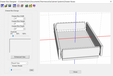

Created a new drawerbox and saved it. Made sure to specify it as MAKE IN HOUSE.
Want to edgeband the top edges of sides, front, and back, and when I try, I get the message "This cabinet does not have enough data to edgeband any of its parts."

The drawer box body data is probably missing. Right Click and select Remove PE Cuts->From Entire Drawer Box, this will rebuild the body data for the drawer box.

That was it, Rick. Thanks!
