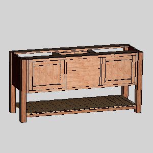

I've attached the cabinet with associated display boards. Every time the customer wants to make size changes all the display boards don't fit.
There are 3x3 posts at each corner, 1x1.5 "stretchers" (not eCab stretchers) to hold the slats displayed at the bottom and then the slats themselves. No so concerned with the slats or posts, but the display "stretchers" are subject to needing resizing every time the customer changes their mind.

I am pretty sure that you will have to remove them and add them back at there new sizes.

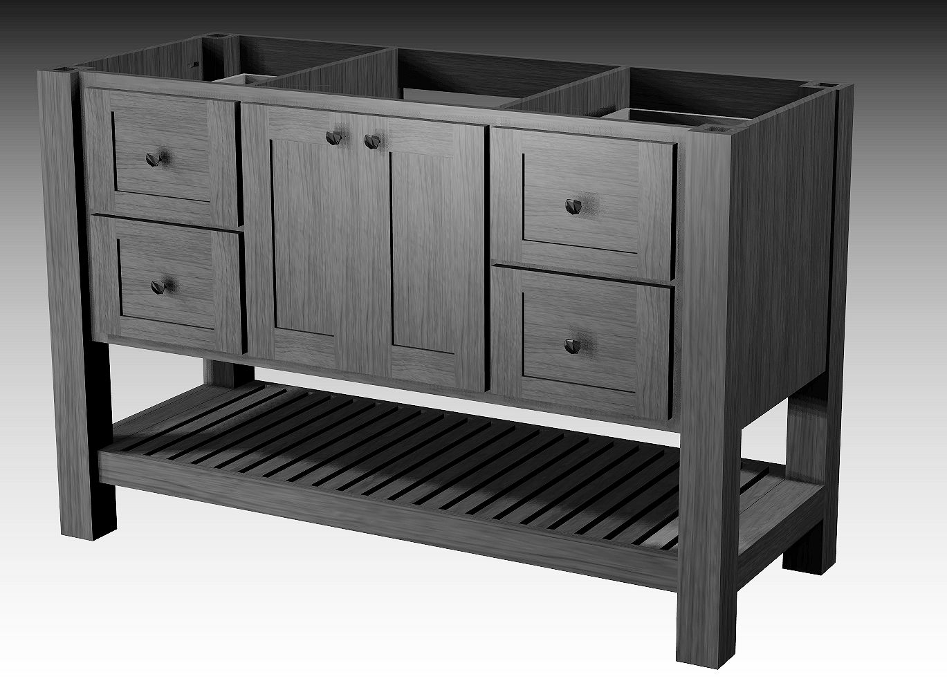

Re: Resizing Display Boards
Donald,
I do vanities like that as an assembly.
Each leg is a cabinet that can be resized
The main box and the slat shelf are also separate cabinets that can be resized.
If you resize the slat shelf width too much, you have to add more mid stiles to the face frame, but it is pretty easy to do.
I think you could do the things you want to do with display parts using the stretcher editor and phantom parts. It would just take some time to create.
