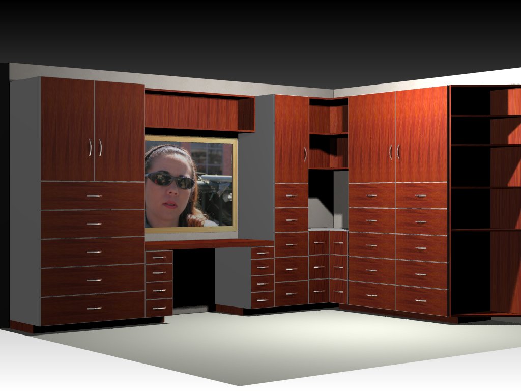

Here is one of the many bids I have submitted using e-cabs: (this one sold)

Roger
Just curious how much does that setup go for? and what materials are you using?

That is melamine;
Rosberg cognac finsh with white edge banding and white melamine carcases all 3/4
You could get the same look with cherry or maple hardwood ply(however finishing costs would send the price way up)
I use Blum hardware metabox slides 330 H, full extension etc....
Corner drawers....
Stainless handles...
There is a wall-bed you can't see on the opposite wall
I apologize, I dont feel comfortable doing money talk on a forum even if its a sale, here are the materials though:
26 sheets of melamine
-17 white melamine
-9 Cognac
39 stainless pulls
30 Blum 330 H slides
16 clip on 120 inserta hinges(free swinging)
Delivery is set for week three of february....

Did you use the corner drawers by Blum as well?
How do they work?
Are they worth the trouble?
