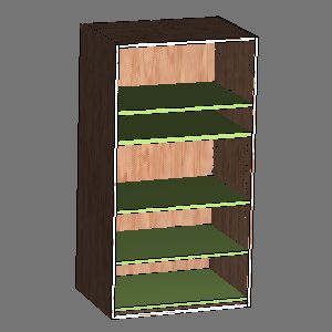

Just upgraded to new build and have a cabinet with NO CUT adj shelves where I can't highlight individual sections to adjust shelf heights between adj shelves. Also each shelf not highlighting for individual shelf selection/deleting. Any input appreciated.

If I zoom in tight on a shelf I can select it and delete it, I deleted all shelves and can add shelves but after adding a couple the problem comes back.
I tried with a standard frame-less cabinet and it works fine, not sure why your cabinet is corrupt?
Do you have more cabinets that act the same way or is it just this one?

Hey Tim, yes I could delete a shelf if zoom in. I used a base cab I set up for a job a few months back. And now trying to convert into a tall pantry. Trying to avoid re -doing things... The NO CUT shelves have a shelf peg hole pattern for 1" stand off spacers for pullouts on Blum slides to clear hinges.
1st one at bottom has holes for spacer block then others above have multiple holes for pull out drawers to be adjustable.
But I need to place the shelves evenly to start so that pullouts are the same.
I guess I need to start from scratch with a standard cab... Just trying to save some time using my old cab with shelf peg spacing aligned with Blum hole spacing.'Thanks

Instead of using your no cut wood, just use regular shelves then when you have them all set turn the shelves in phantom parts and they wont cut. you can change them back if you need to see them.
