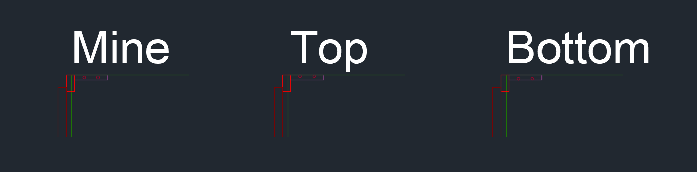

Its been a long time since I've set up my cabinet library. I can't remember all the downsides to using the KD/RTA fastener. I just applied KD/RTA fastener and without spending alot of time on it, It only allows me to put the hole at the top or bottom edge of the stretcher. Thanks

Give the attached cabinet a look over. Try resizing if you do, any changes, etc. The left side of the cabinet has a modified KD/RTA pattern applied and proper inset values to place the holes in the correct spots. The only time you would need to change the pattern would be if you were to go with a different width stretcher, then you would need to add or subtract that difference in the inset values to place the holes correctly.
I don't know your library or uses of it, so make sure to give it a good look. If it works I'll give you the steps so you can get it done on your libraries.

Clint,
It seems to work. Im going to play with it and throw some different scenarios at it and see how it works out. I will let you know.
Troy
