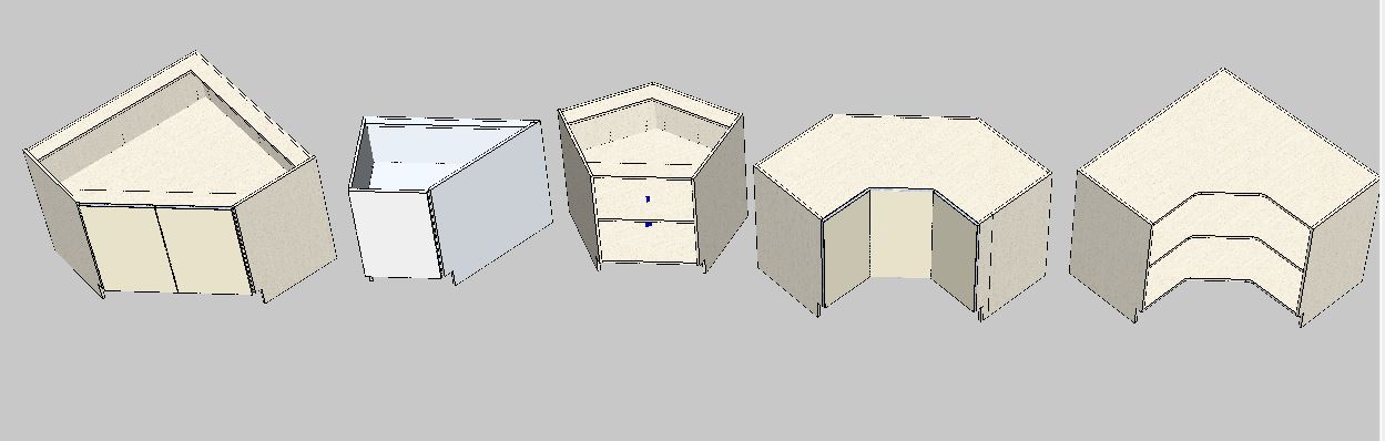

Some options, but I'm betting you want the end going back the other way (now I'm being vague) which is possible but it depends on how you want it to look, hinges, framed or frameless so sketches and details ect ect

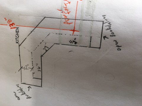

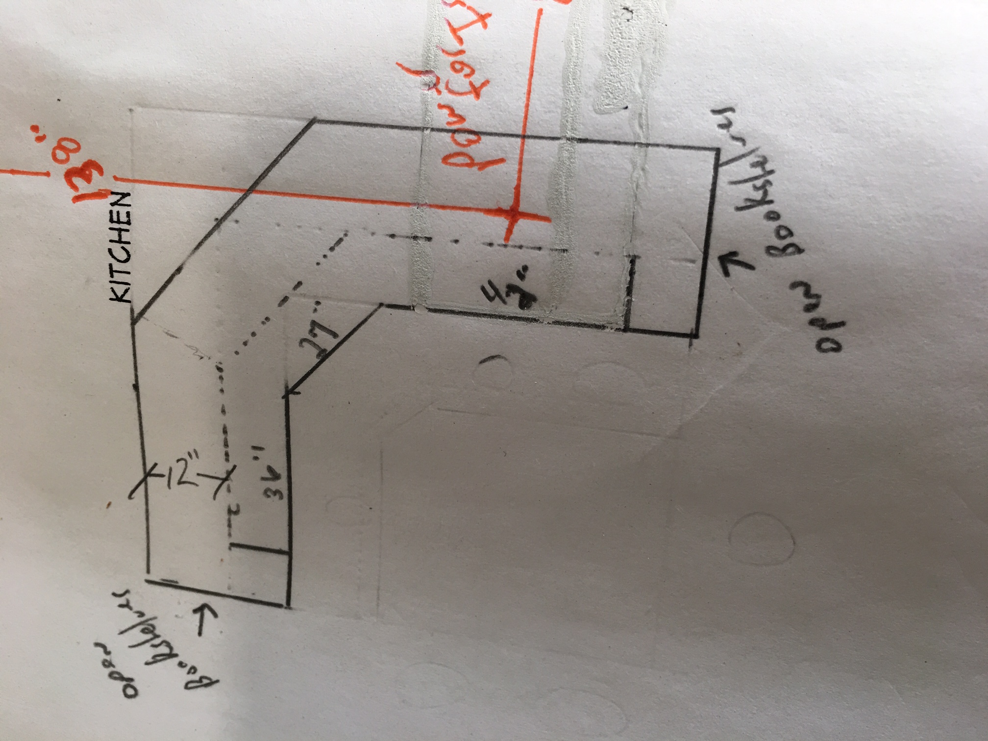

Oh wow, I did not realize there were that many options on corner cabinets. I am attaching a sketch below of what I had in mind for this particular project. They will be framed cabinets and the face of the cabinet will be on the long side of the sketch.

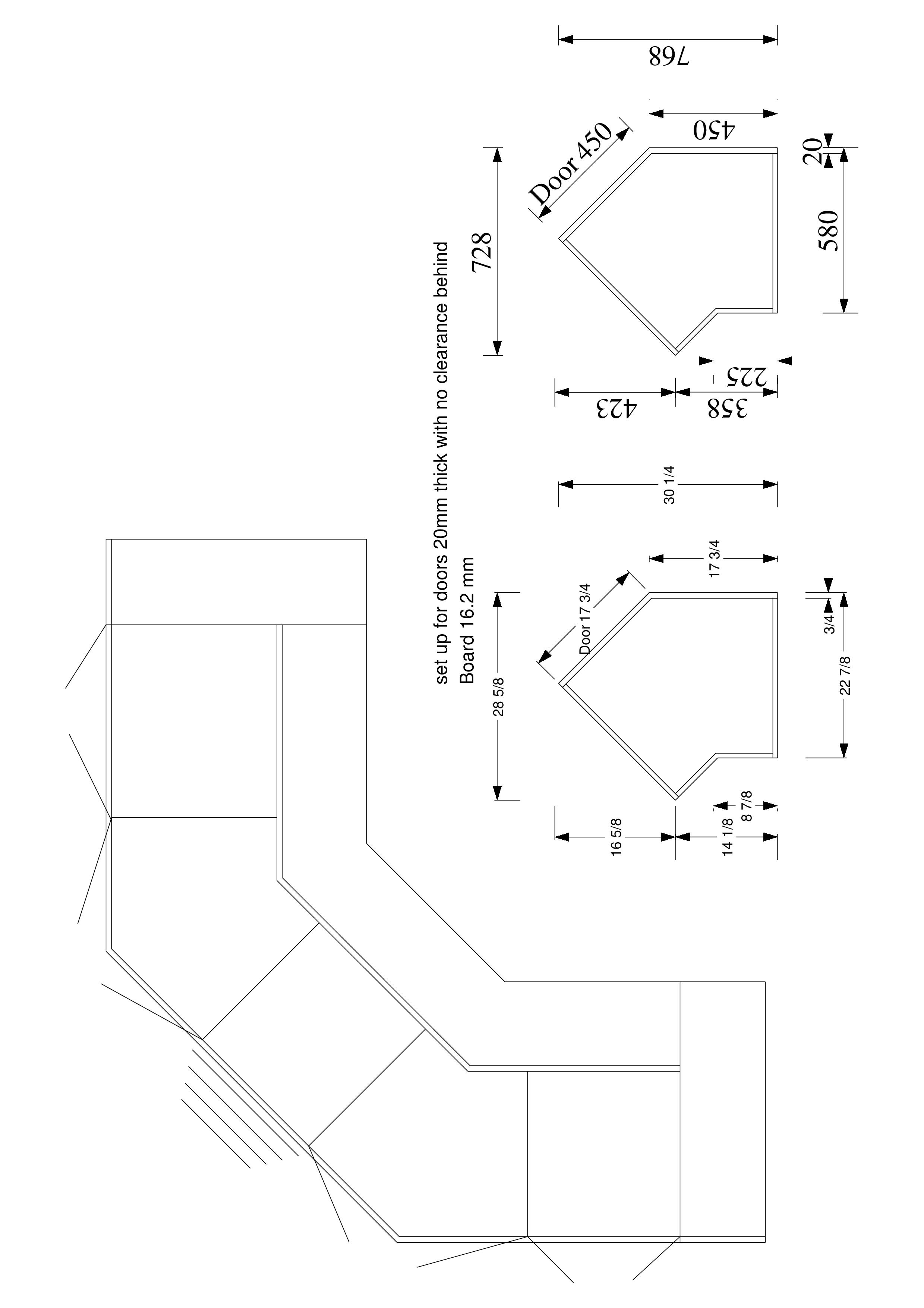

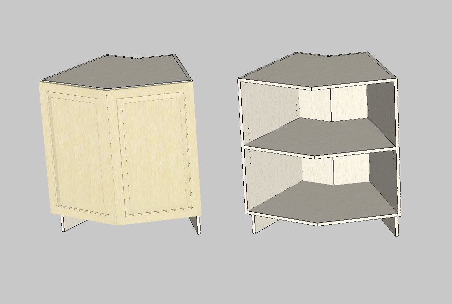

I have attached an assembly that is frameless that may be useful? I don't know if you just want a pretty picture or a production model.
It is height adjustable but not width, It has been set up for 448mm wide doors
Take it into the cabinet editor and delete and add the the stuff you and don't want.
Save it as a new assembly and put it into your room layout
