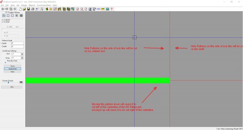

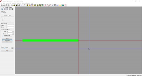

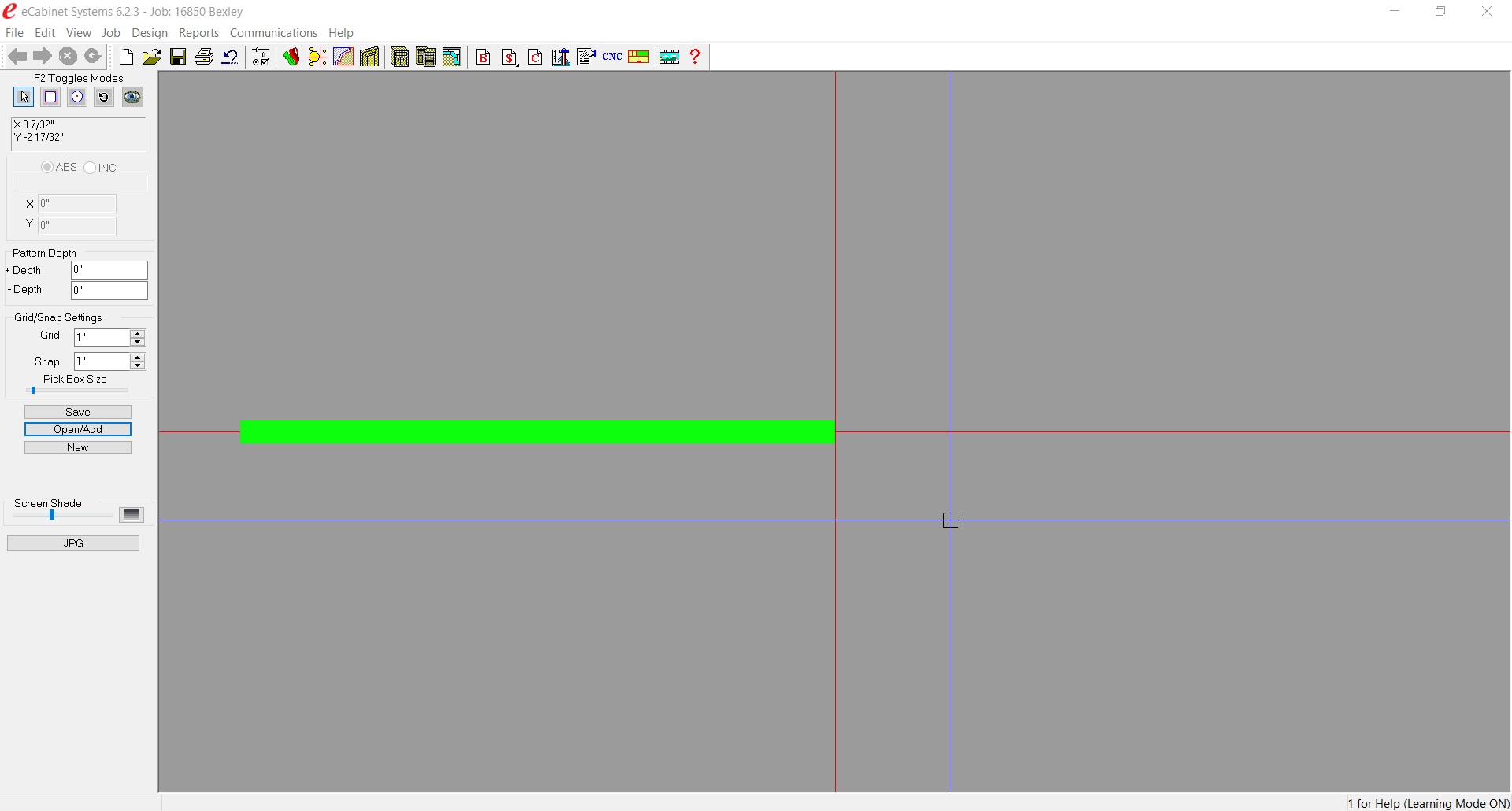

I did this in the past with a hardware pattern as you mentioned
The only problem was I had to apply a different hole pattern (for length) for base cabinets, tall cabinets and upper cabinets as well as different lengths for different heights of uppers. For a one off it is just as tedious as part editor cuts.
I applied the hole patterns to a phantom shelf. This allowed me to adjust the starting point.

Posts: 4763
Re: Shelf Standards or pilasters
Stuart,
In the hardware hole editor I am not sure the lines are actual X and Y Axis.
As for my shelf, the pattern is drawn centered on what would be the x axis and runs left of what would be the y axis. This placed the cut on the end of the cabinet centered where my kd fitting would be. If I draw it on the left of the y axis it will place the cut on the shelf. This is how you do different hole patterns on different parts that a KD fitting would require.
