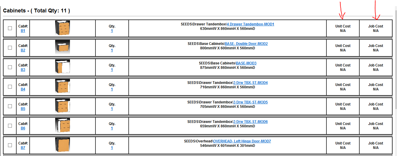

I've tried to search on how to access the columns in batch cabinets for the Unit cost and Job cost. But nothing is found or talk about it in the help section, youtube nor vimeo. But you are able to get the cost summary, where in this report shows you the total cost for the material and labor. If each cabinet has an input on the labor cost it section.
Labour costs have been applied and material costs have been applied so in batch its n/a
Can anyone point me in the right direct on what we have overlooked?

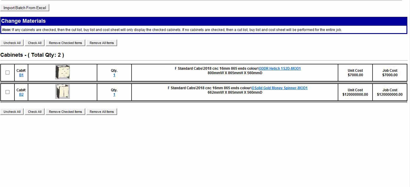

Hi Neville

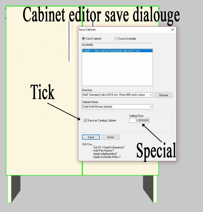

To get that particular column to show up you need "Special" jobs.
Special jobs Like the one below.
See the little c in the circle, that indicates its been saved as a catalogue cabinet.
Also when you load it into batch cabinets it can't be changed in the batch cabinet loading screen, even if you set and save parameters in the padlock cabinet lock area, in the cabinet editor (as far as I can tell)
To adjust it I think you have to take it into the cabinet editor.

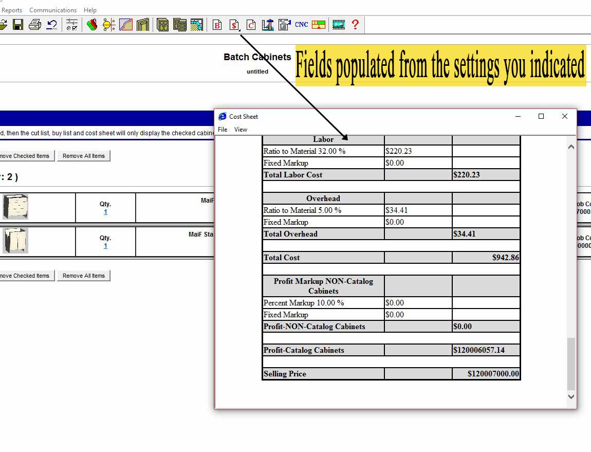

I think the settings you indicated show up under the dollar sign cost sheet.
Hope that makes sense
