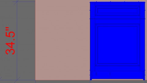

I've got a little list here of issues that I've isolated concerning auto-dimensioning, scaled print, and cross-section views:
1- Auto dimensions:
For the sake of material thickness variations, we have hardware hole patterns that protrude beyond the bounds of the cabinet (in this case, 1/8")

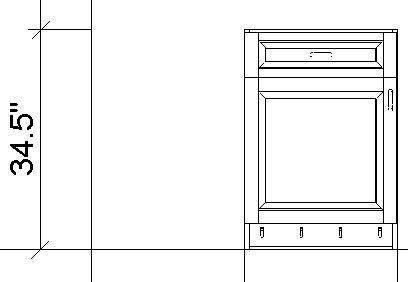

You can see them in this picture, as well as the automatic dimension from the Custom Layout, which is correct at 34.5"
If I create a Scaled Drawing from this view, it is also correct.
CL scaled print.JPG (19.49 KiB) Viewed 5158 times

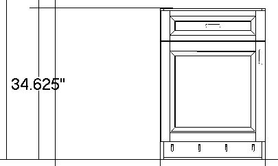

If I take this view to the Line Drawing Editor and auto-dimension it, the dimensions include the protruding hardware holes (definitely don't want that):
LDE scaled print.JPG (19.2 KiB) Viewed 5158 times

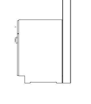

2- Cross Section View
If I create a cross-section view of the cabinet, and then a Scaled Print, the scaled print does not show the cross section, rather it seems to just show an end-view of the cabinet:
scaled print cross section.JPG (12.56 KiB) Viewed 5158 times
