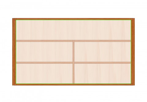

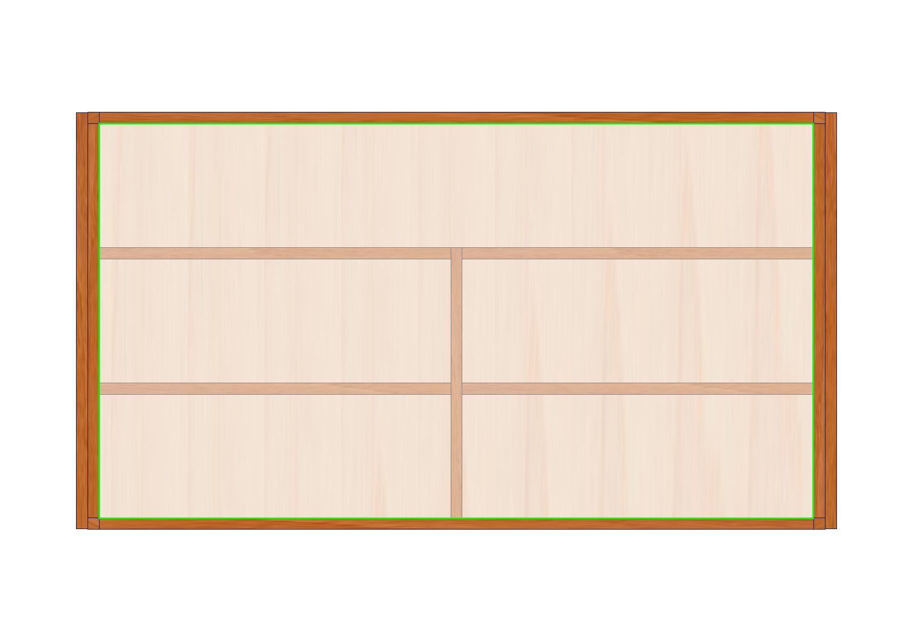

I've designed the following frameless half overlay base cabinet which will be used in my woodshop and sit on 4 casters so it can be rolled around. That said, when I go to add drawers, eCabinets does not recognize the smaller drawer spaces but rather the larger cabinet as one drawer space.
FWIW - I used a stretcher for my partition since I couldn't figure out how to make a partition which didn't extend the entire length of the cabinet. II believe I can make a smaller partition but would need to make a stretcher which extends the entire length of the cabinet first. In my mind it's easier to source/optimize smaller parts and thought it would be easier to cut all stretchers the same length. Do you agree? Is the drawer opening related to the stetcher versus partition? Is there a fix?

I was able to add a partition which had a top inset by modifying construction settings before adding the partition; however, when trying to add drawers, I can only highlight the left or right side of the cabinet from top to bottom. Obviously the stretchers aren't allowing it to recognize the split area ... I can try to set shelf settings which inset from the front, add several shelves which are rear stretchers, modify construction settings to inset from rear, and add more shelves acting as front stretchers and perhaps this will work but is it the right way of doing things ... seems there would be an easier way??

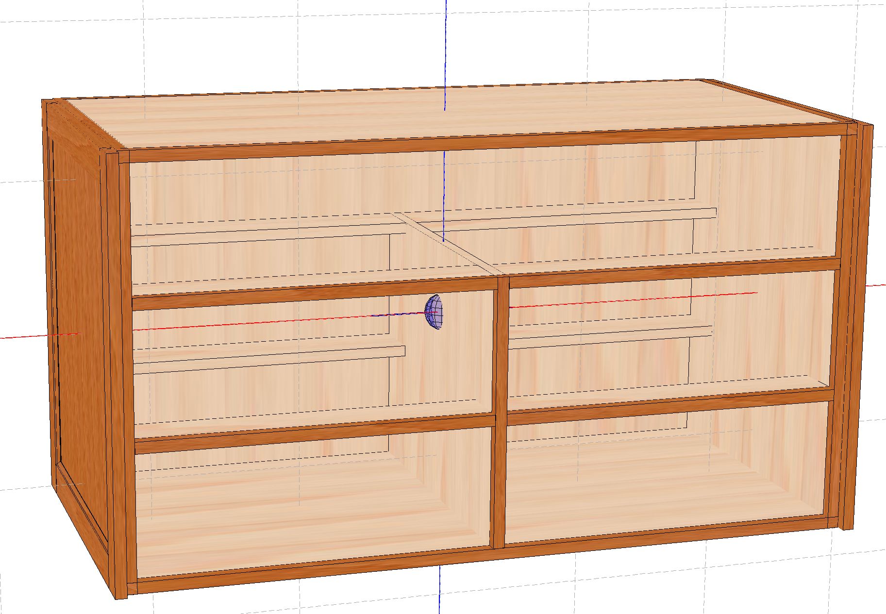

So I would build one by adding in a fixed shelf at the height you want the partition to be. Make the shelf a Phantom Part so it does not go to the Cut List or to CNC. Insert a partition below the shelf. Add a negative inset to the top of the partition to get it through the shelf. Add in your fixed shelves below to divide the openings with a back inset to get them to the front. Add stretchers for the back "shelves". Add drawer boxes accordingly.
You have seemed to discovered it, but openings for doors, drawers, and drawer boxes can only be created by shelves, partitions, and face frame components.

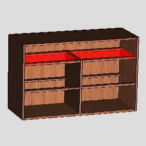

Thanks for the reply Clint, I was aware of Phantom parts but never had any use case for them. I did as you suggested which did indeed allow the top to become one wide section; however, I'm unable to place a shelf/stretcher at the same height as the Phantom part which is highlighted Red in the editor. I suspect deleting it is not the answer ... I must be doing something wrong?

I tried moving the Phantom part up 19mm, removing the -19mm top inset on the partition, and was able to align my shelves with the partition for the desired height; however, when I try to add a drawer to the top, it will not allow me to use the Phantom part area.

You are essentially designing the cabinet the same way as your second post. The only difference is first adding the shelf as a phantom part, then adding the partition with the negative inset. You can then add your stretchers for the the top area where the shelf is. You'll then add shelves at the bottom to divide the openings. Then add stretchers to be the back "shelves" behind the shelves you already added in.
I've attached a sample cabinet that should give you something to look at and compare. Pay particular attention to the Associations of the stretchers. The are set in a way that if the shelves move up or down, or partition moves up, down, left, or right, all the stretchers will move with those parts.
