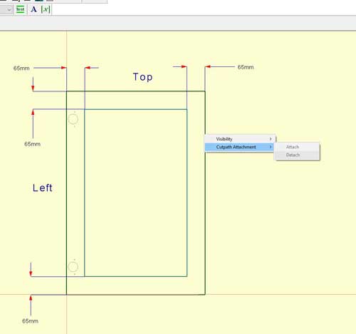

In the part editor, Is there any way to associate a correctly named tool from control nesting to a path?
A bit like the cut path attachment thing but without the programing

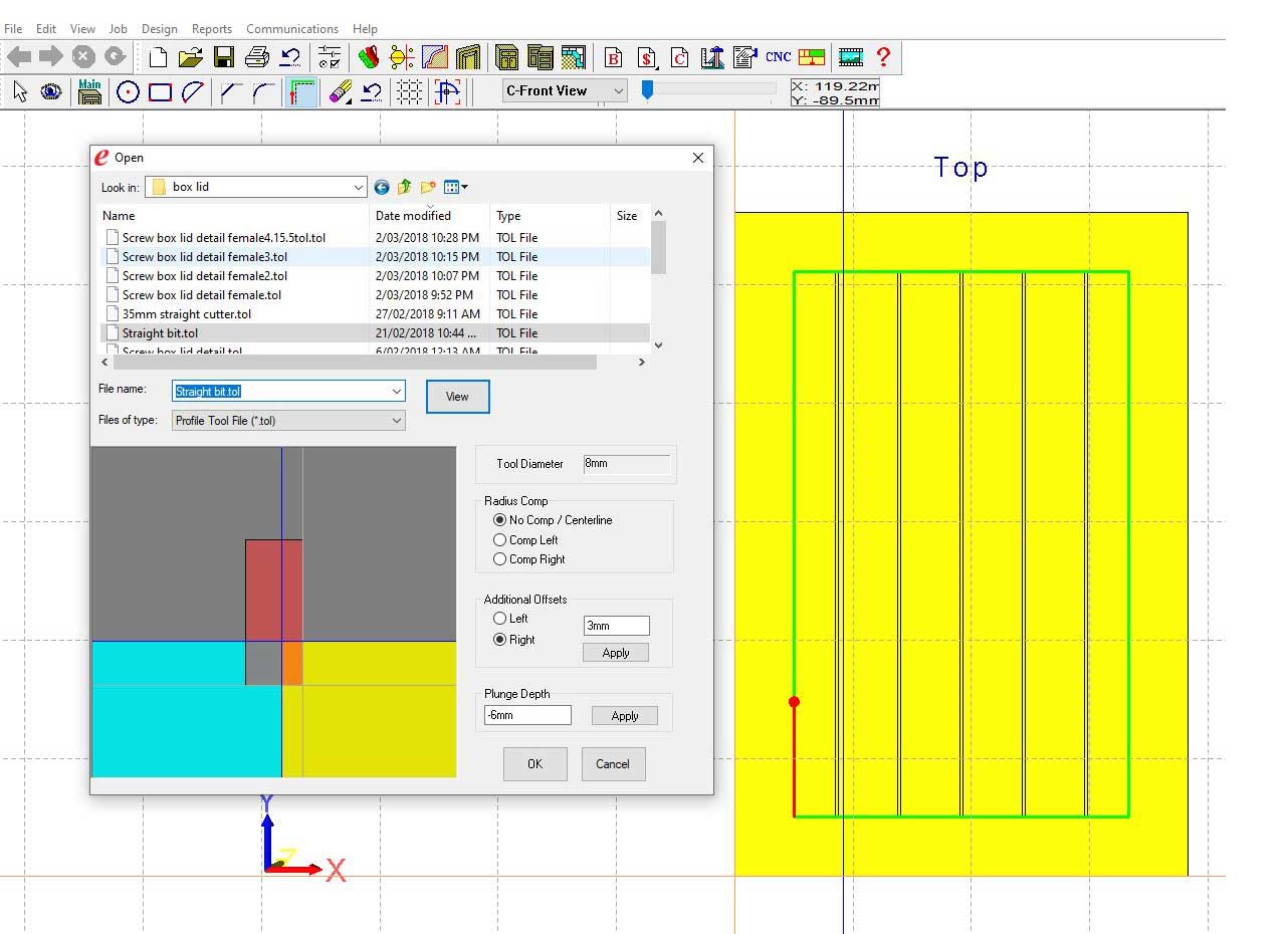

( I briefly played with the profile edge settings a while ago but I wasn't very successful. ) and that is more of a modeling, zip back and forth, time consuming tool which is probably great if you can make it work and you don't have a real tool.
But in the interests of expeditiousness instead of adding a .tol tool, if you add the same name tool from control nesting as long as that tool and the sheet or board material was in the group it would follow the path it was attached to?
Like in the picture below
Any tips, tricks or ideas appreciated.
