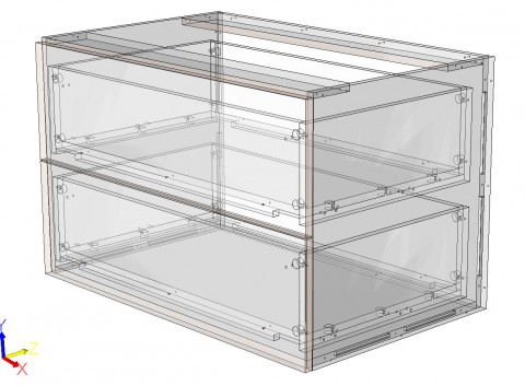

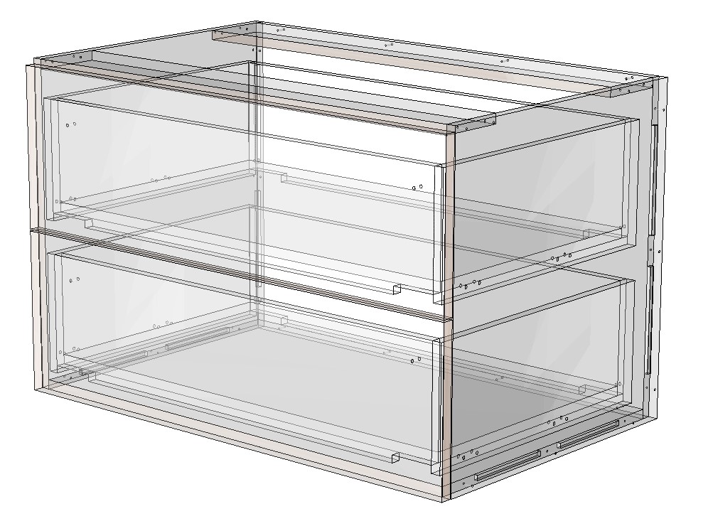

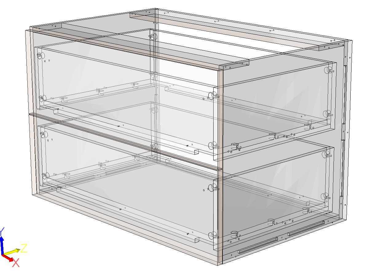

My drawer boxes are losing their rafix fittings every time I change something in the construction settings. I have to insert them again via Adj Features/Drawer Boxes with Drawer Fronts. This was happening before the update to 6.2.4 and still now.
Has anyone else found this to be a problem?
Is there a solution?

Hi Ralph. thanks for the reply. Unfortunately, these drawers were done in the drawer designer and saved to my drawers with the rafix fittings baked in. there is no reason that they should disappear and in fact, the pre-drilled screw hole which is another RTA fastener I the same drawer is not lost, only the rafix geometry... Strange
