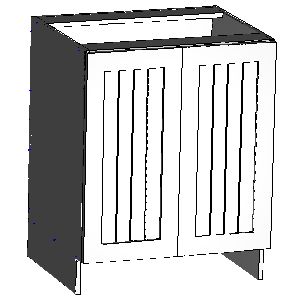

Re: MDF shaker doors
The way we handle them was to make a library of cabinets with MDF doors, add pockets and constrain them in the part and node editor.
So there are 10 or so basic cabinet variations.
The cabinets are resizable.
For panels we use an end, so if you place it in a room it aligns to the back, but often we use assemblies.
If we need doors only but with hinge holes, we phantom part what we don't need, but yeah, you need to remember hinge, open side and top reveals.
You can adjust hinge hole positioning, change handle holes, and drawer runner drilling patterns without loosing the constraints.
Drawer boxes need different units for each style because you loose constraints when the drawer fronts are re-applied.
We also have done country V groove, and constrain the cabinets to say 600mm to 850mm 2 door so the grooves remain even.
You dont need as many cabinets as you might first imagine.
I found it easier to start with the widest cabinets, set the formulas, then take off pockets and constraints as you work down.
But yes, its not the same as being able to flip out one MDF door design for another one when a customer wants to see what their kitchen looks like with another type of door on it.
