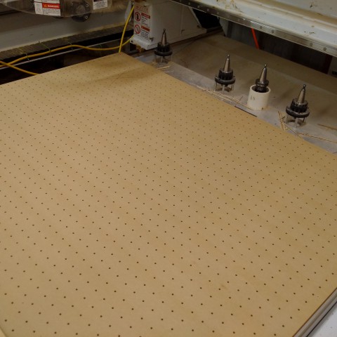

We decided to experiment with that as well, and tried drilling holes in our spoil board. It seems to work very well. ProTip: Don't forget to flycut the spoil board (on both sides) before you drill the holes! Once drilled, it of course won't lay flat for flycutting anymore. I think I put the holes at 32mm centers, 5mm diameter, because why not. Ended up with something like 5,200 holes in the 5x12 table.
On top of the spoil board we just use 1/4" MDF as a wasteboard. We don't attach it in any way, it just lays there. Though, inadvertently, there is tape residue on our spoilboard from other projects that we do, and the waste board sticks to that enough so it doesn't slide around... :mrgreen:
As for the unused portion of the table, we use a 12" wide piece of 1/4" melamine to cover it. But we don't have the fancy-dancy pushoff bar to worry about either. We still have to unload by hand. In the snow. Uphill both ways.

  • I might tend to stay away from drilling a grid of holes through your WASTEBOARD. I have seen it tried and it does not appears to produce the improve vacuum being sought. These holes have more of a tendency to allow the vacuum to escape more quickly though uncovered "holes" and diminishes the overall vacuum under the sheet/parts.
