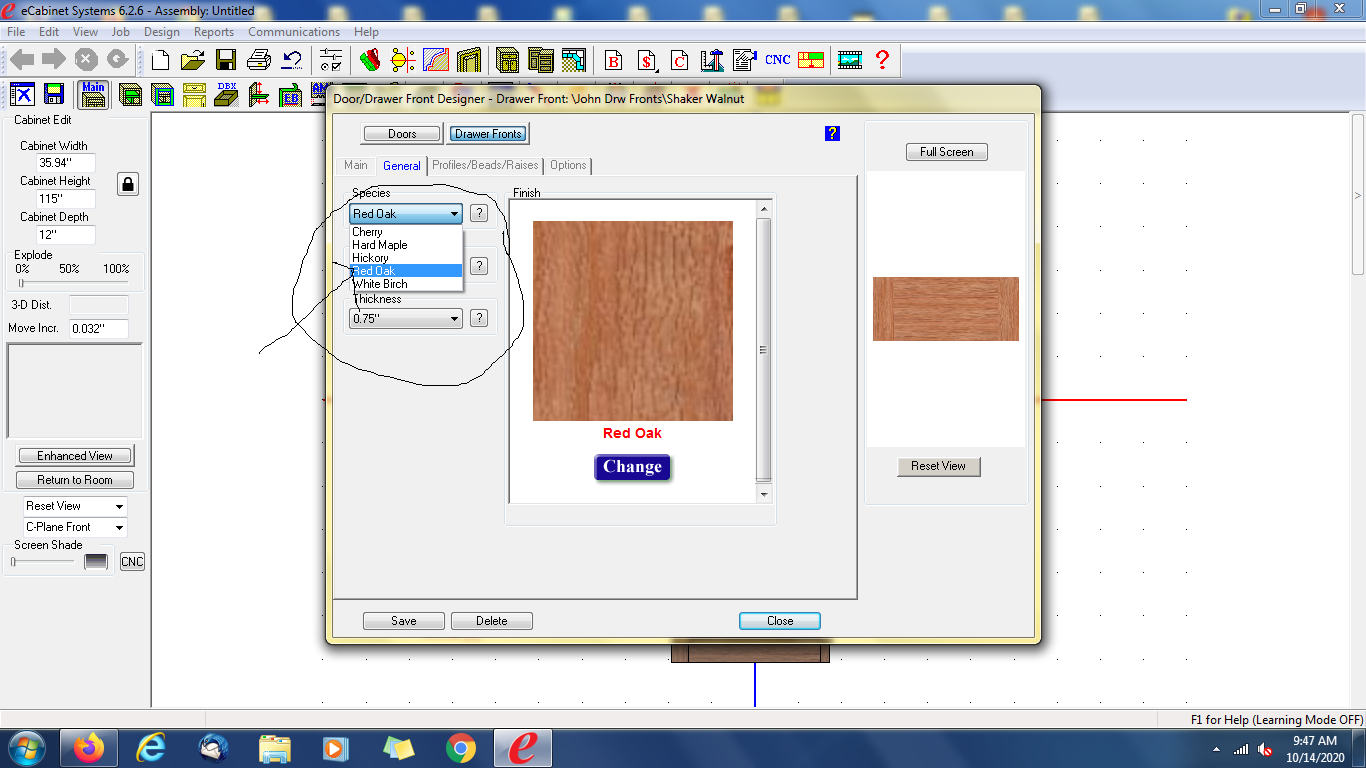

Is there a way to add more material to the drop down list for doors and drawer fronts? I changed it in the door rails and stile set up but it did not change it. I need walnut as an option.
Add wood species to door material

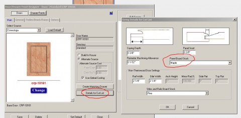

You can change the panel and sticks here
Tim
Hope this helpsTim

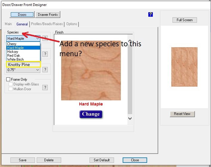

It's been a while since my last post lol
I have a question relevant to this topic of course.
The OP was how to go about adding a species to the wood in DOOR and DRAWER editor.
I am still wondering how to add this because this suggestion doesn't allow it to add a new species such as "Knotty Pine" to the drop down menu?
I included snap shot for reference.

My understanding, having chatted with support people at Thermwood, this is a limitation that they want to address in a future release. A lot of editors in eCabinets were built around doors and drawer faces that Thermwood offered for sale. Same with all the door/drawerface types. Part of an online store system Thermwood was trying to link to eCabinets. It never took off the way they were hoping it would. Not sure when eCabinets will be revamped to be more flexible where users can add their own material and door/drawerface styles.
